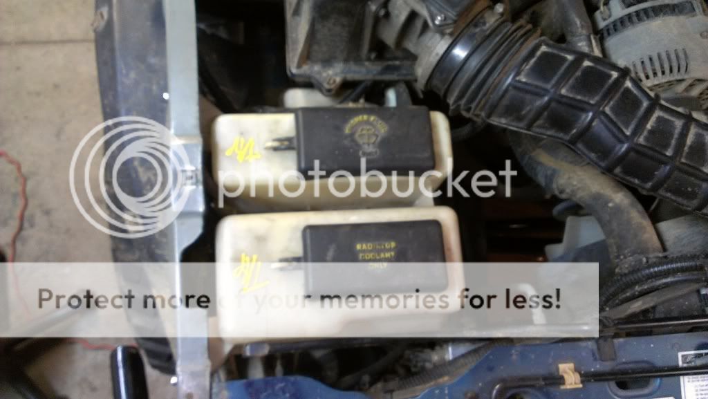

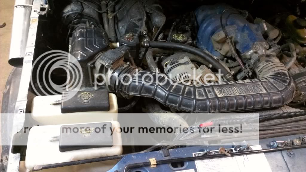

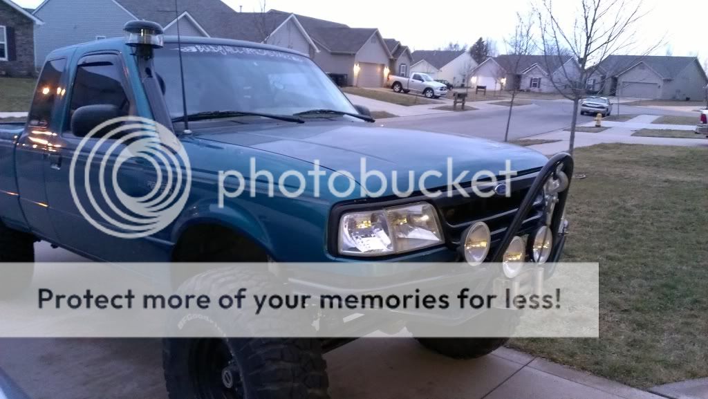

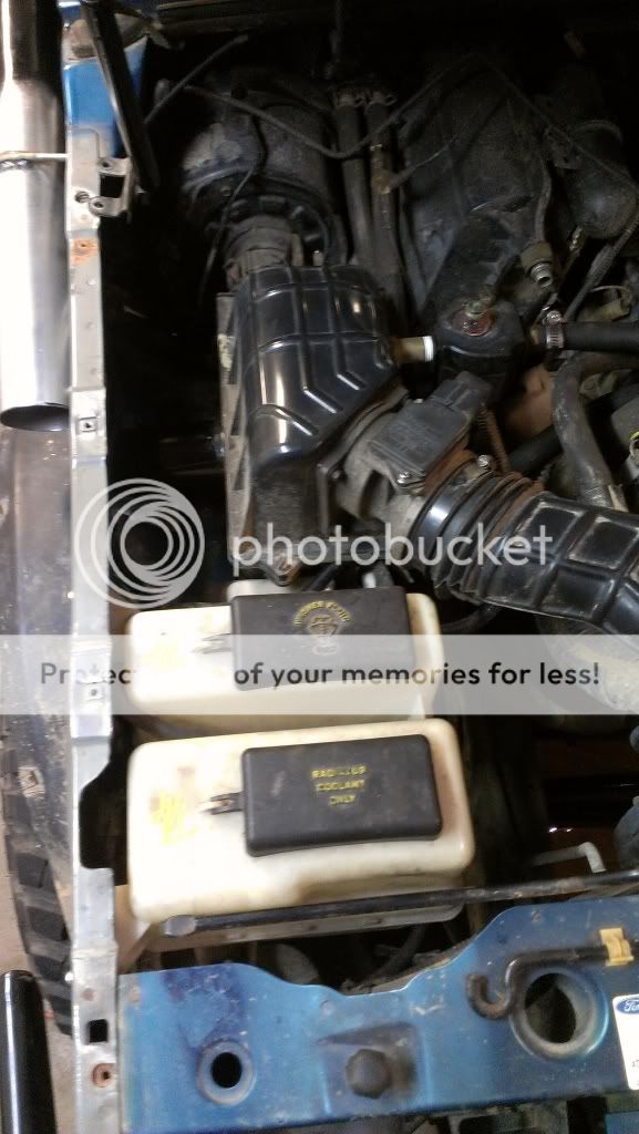

Snorkel is done for now, I still don't have a 90 degree elbow but I needed to get it back together to drive it.
I had to get another washer/overflow tank since I can't use the stock one. So a trip to the Pick-A-Part and got one from a 98 explorer and had to grab a pump from a 97 Ranger. The explorer had a dual outlet pump for front and rear wipers. The tanks fit perfectly....here are some pics.

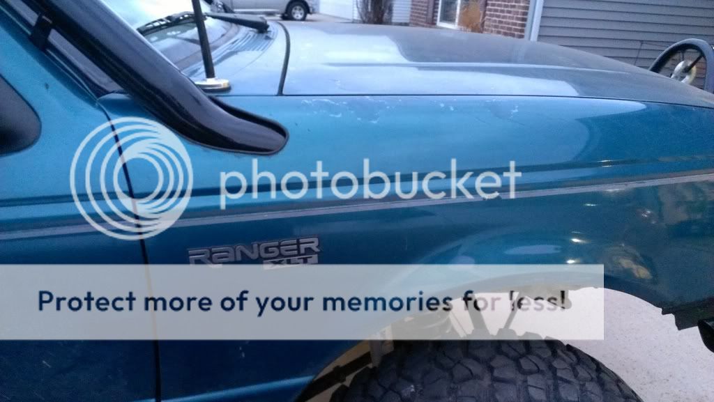

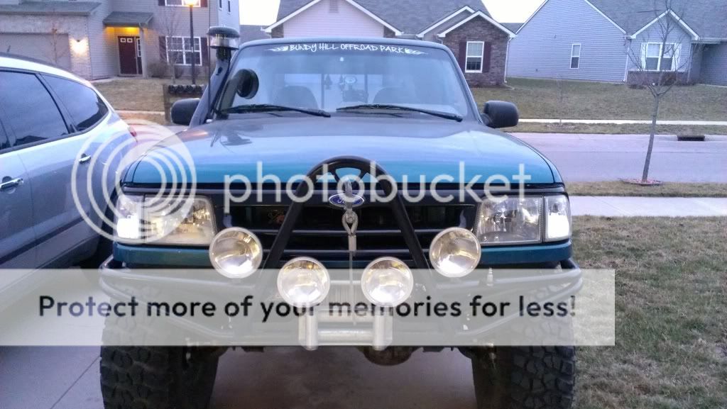

I made another snorkel for a friend of mine. He has a 97 and the filter location is different from 95 and newer. Here is what I did to make it work for him.
Escorts 2nd SAS
Just used a silicone coupler with another short piece of tube.
Me likey.
Sent from my rooted SPH-D710 using Tapatalk 2
Looks AWESOME. I feel like the exploder needs a snorkel now. Where did you get the piping and the John Deere thingy?
You can get those pre cleaners on EBay or from Stieners Tractor Parts catalog or a JD dealership.
I got mine from a Combine salvage yard.
We both just used 3" exhaust pipe.
