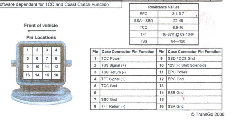

You can unplug the 16 pin connector on drivers side of transmission and use an OHM meter to test TSS sensor
Drawing here

It is possible for one of the TSS wires to break inside the pan on the harness, so if external wires TSS + and - don't show a connection, you could drop the pan and check.....................but longshot
Drawing hereView attachment 52390
