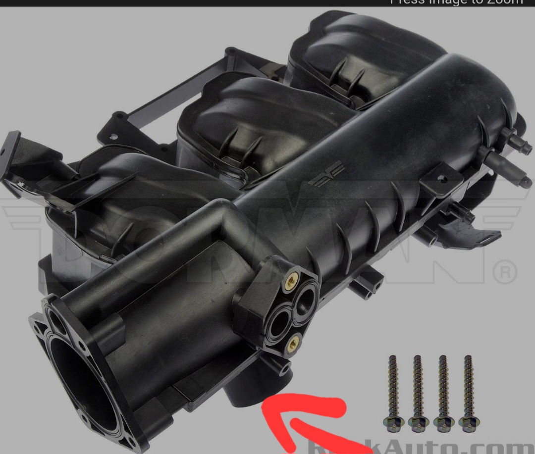

I got a picture of the intake manifold from rockauto. I put a red arrow pointing at the EGR port. I will still throw up some pictures of mine in the morning. This is for a 95 ranger 4.0 so yours may be a completely different beast.

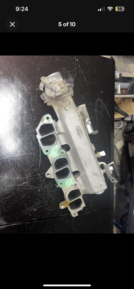

I’ll take a look for that. I found a picture of my exact manifold and I don’t see anything that jumps out at me as that EGR port you were showing me. Could it be elsewhere?

I was afraid of that. 95 was a change to a plastic manifold. I may have been leading you in the wrong direction all along.

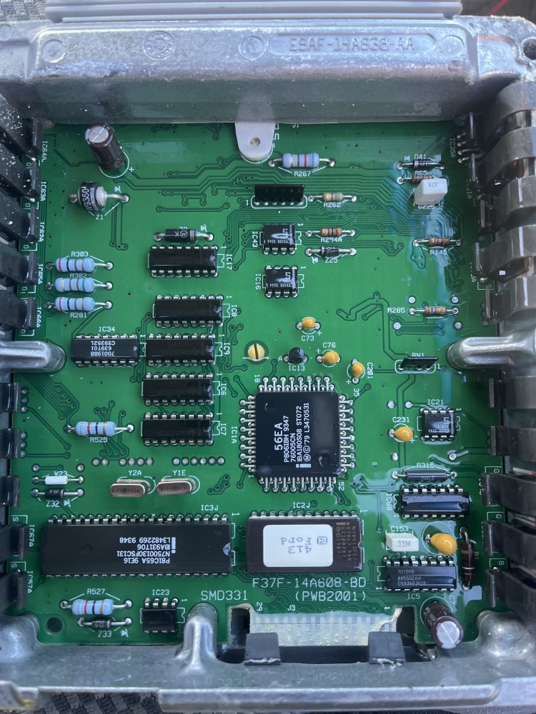

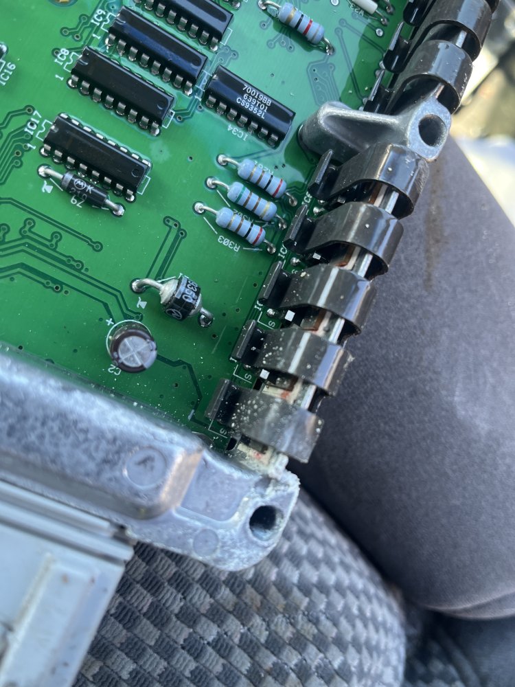

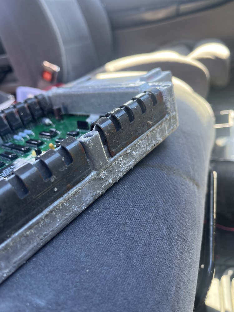

Just pulled my PCM out. Lots of powdery white corrosion around the sides that looks like it is leaking out of the module itself but upon opening it up, the capacitors look to be alright and the rest of the computer board looks to be free of damage from corrosion or electrolytes. There is one spot along the side that looks like it has more corrosion than the rest. Unsure if this could be the issue. Pictures below. Any input on what this white stuff is, where it originates, or if this could be the issue is appreciated
