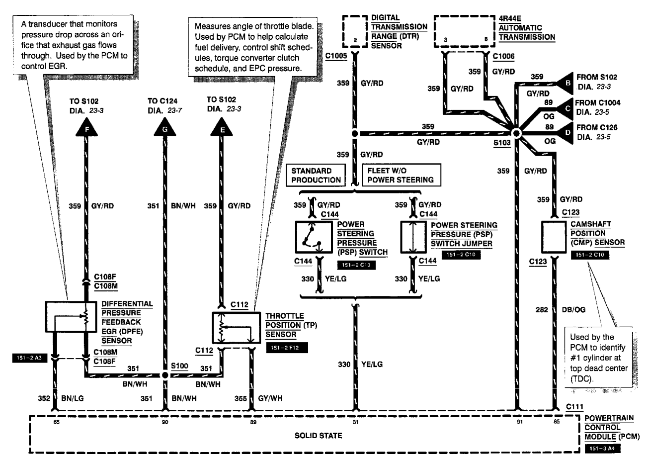

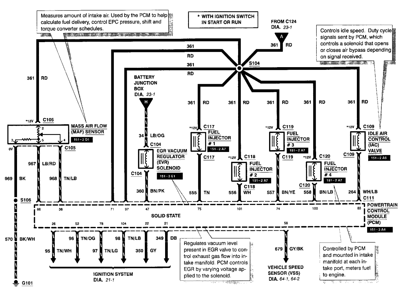

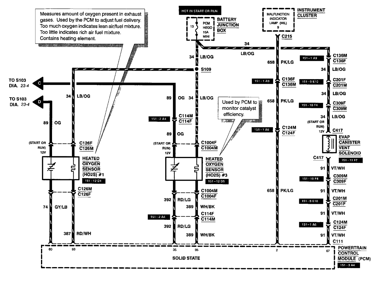

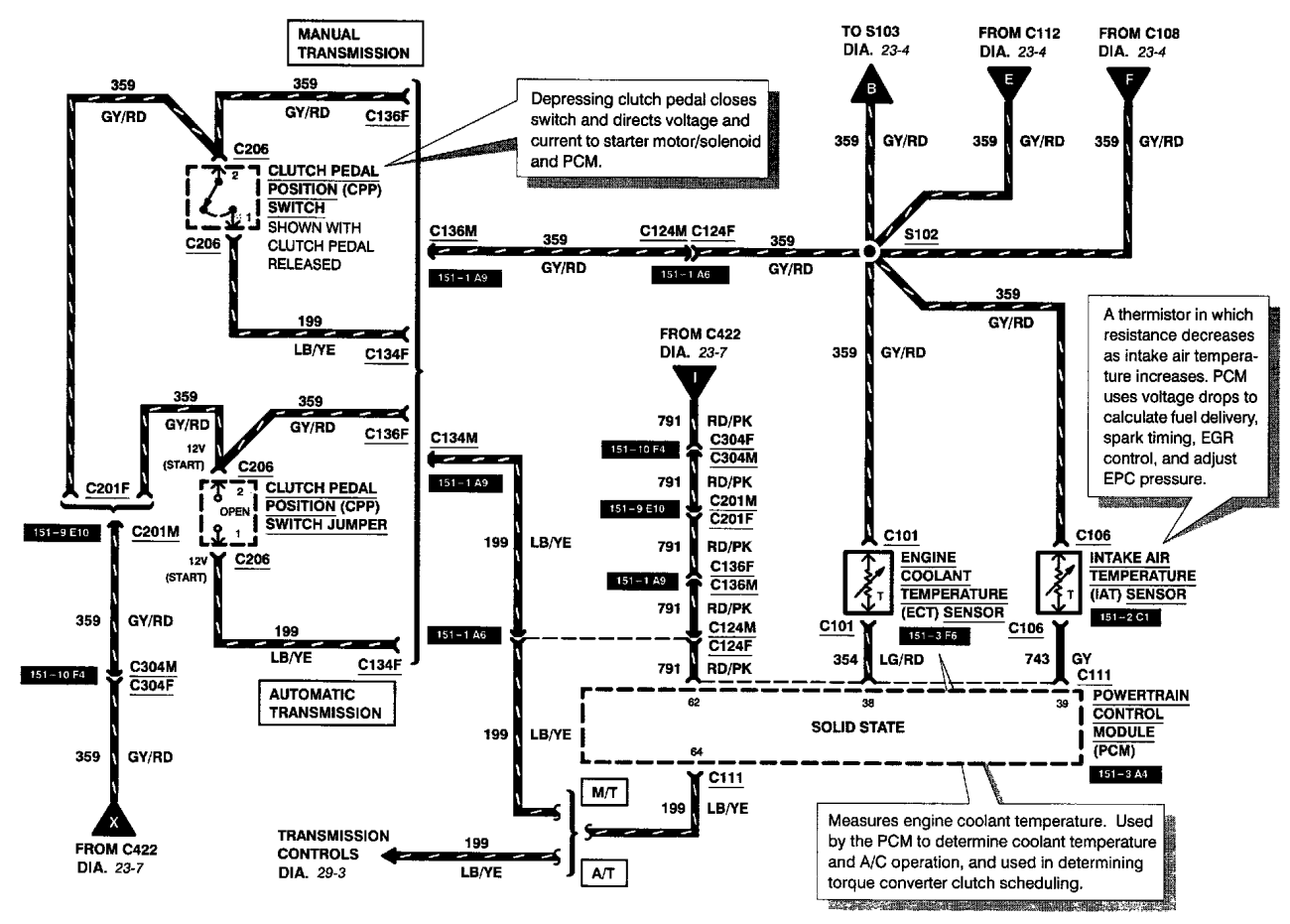

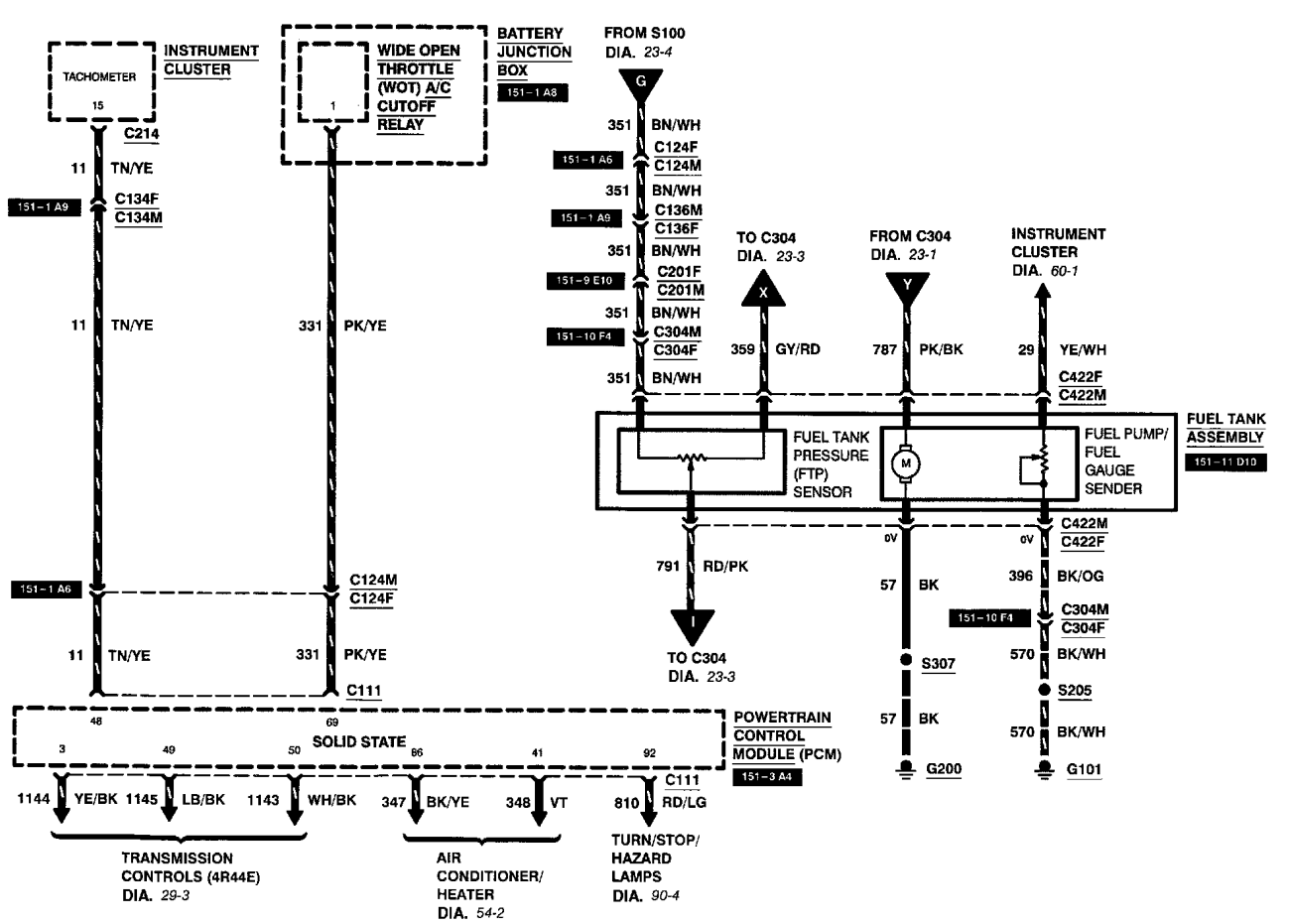

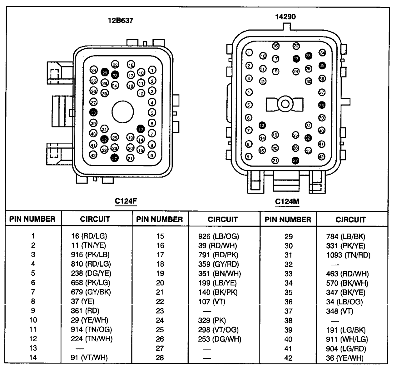

Hello, does anyone have any information or diagram on the pins if these two red connectors on my '99 2.5L? It's where the engine/power distribution harness meet the engine harness. Trying to power the body computer and harness off of a standalone ECU and harness.
Is this it?

See if the numbers in these diagrams match. You can also verify by wire colors
