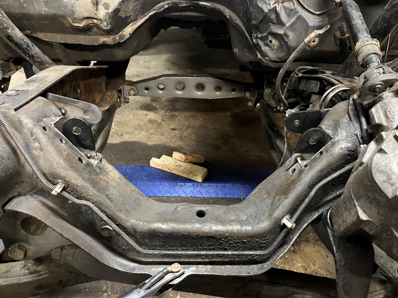

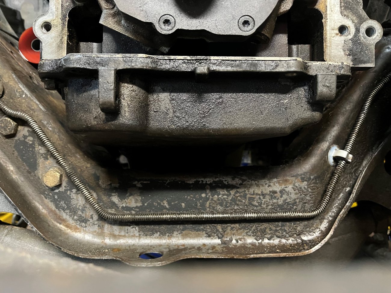

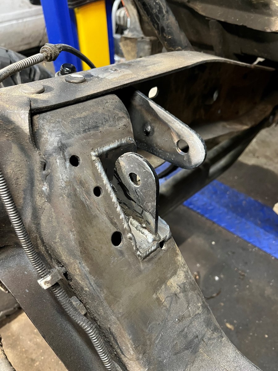

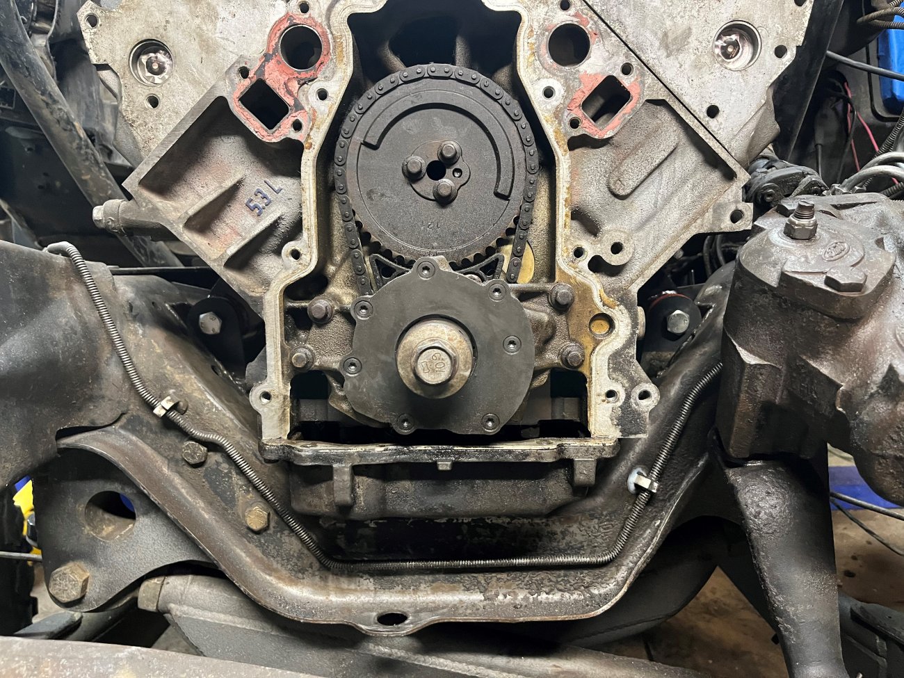

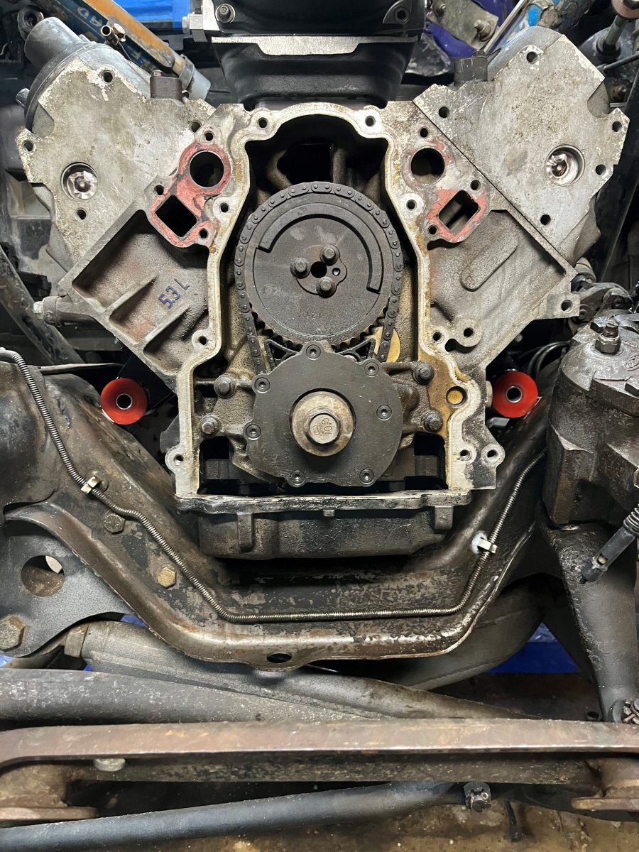

mine currently has a gen 4 5.3 LS in it. it definitely takes some fab work, but not too hard. the hardest part was getting the steering shaft to fit around the headers using u-joints and heim joints (as I wanted to keep the headers on the inside of the frame). the mounts did get more gussets on them, the pics were just as i was going along. so far, I've had just over a year of run time since the swap
you got a running video of this thing. i think this is awesome
It took me right about 4 months of weekends and occasional few hours after work. It really wasn’t to hard. The LS is a pretty compact and narrow engine so it fits in tight places well. This was my 6th LS swap so I have some experience with them. Definitely easily doable for someone with some sort of fabrication experience. In my case I had to get rid of the AC hvac box on the firewall and am going with a non AC hvac box to retain heat for the cold fall months
