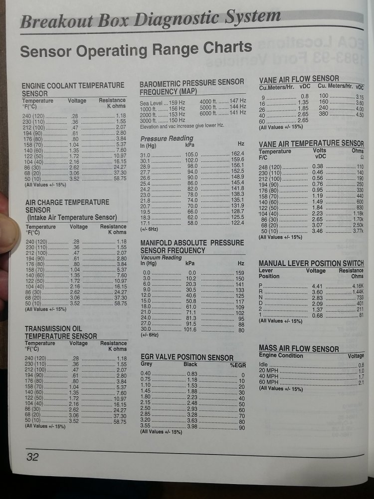

Check your ECU power relay to be sure you've got good voltage feeding the ECU. How are you checking voltage at the ECT? Battery negative to the LG/Y wire or the BL/W wire? The ECT is basically a thermistor, so voltage on the LG/Y wire should be close to 5vdc (if the ECU is getting good voltage), and voltage on the BL/W wire is after the thermistor. I think that's right :). Here's a sensor voltage chart.
