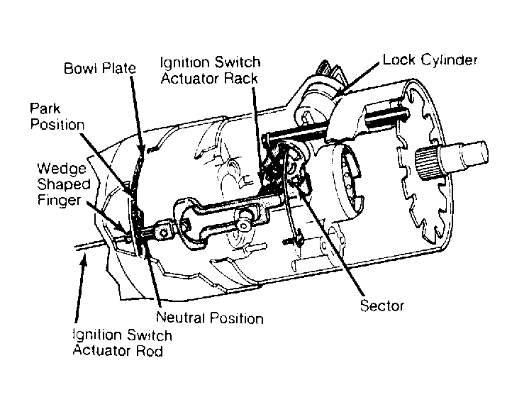

Drawing here of upper steering column where key is: https://www.2carpros.com/images/question_images/71901/original.gif
Not a Ranger drawing, just gives you the idea of how it works when you turn the key
Also shows you the steering wheel LOCK mechanisim
