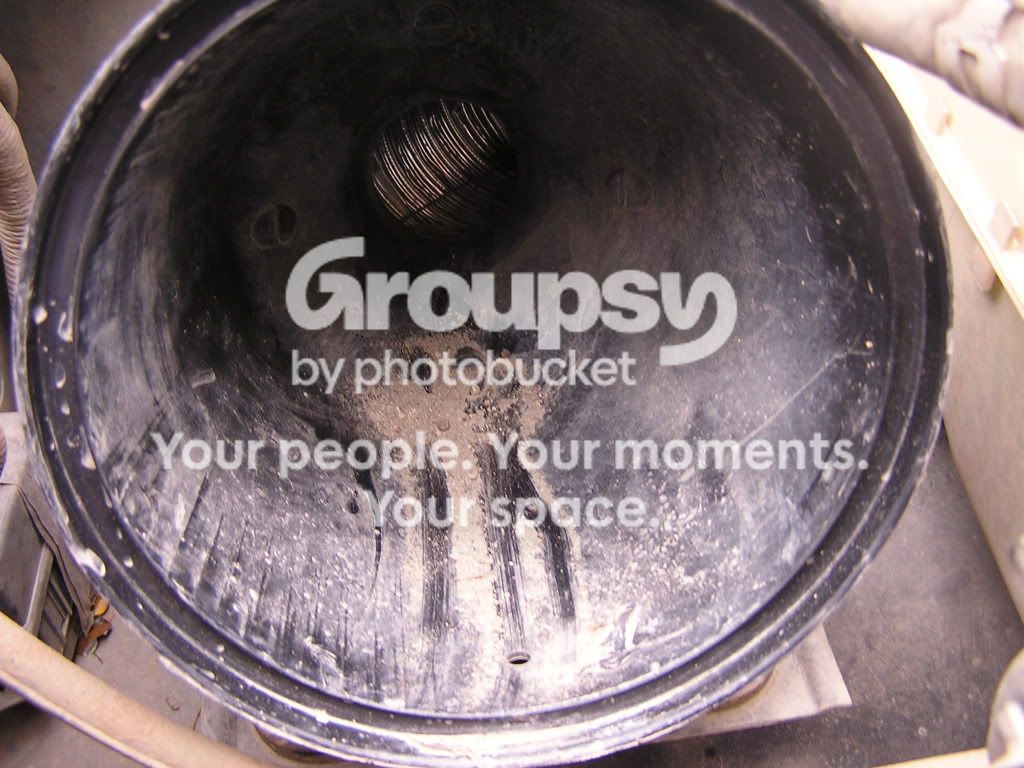

Hydro locked my engine, bent a rod and sent a chunck of so

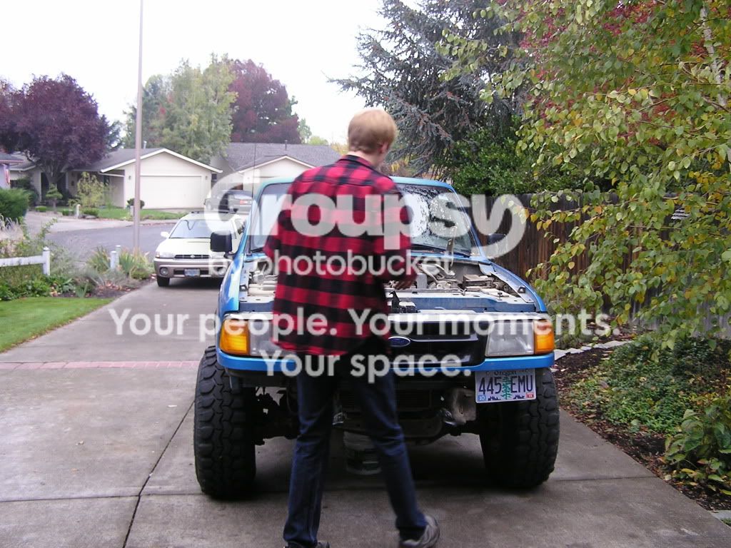

s/amthin through the oil pan, I dont feel like typing a lot right now so im just gunna post the pics. Whole process of removing the engine took 2 days. about 6 hrs, I have never done it before. Im gunna start tearing into the engine tomorrow and ill keep posting picks as I go.
IMG]http://i1003.photobucket.com/albumf158/BabyBleuBeauty/P1010330.jpg[/IMG]
MY OIL
COOLANT IN OIL
HOLE WHERE ENGINE USED TO BE
HOLE IN OIL PAN
