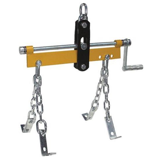

A recently picked up an engine leveler. I use that if I'm pulling/installing an engine and trans together.

One of these days i wouldn't mind have a engine leveler like Snoranger has.

Engine leveler is by far the nicest though. Need some tilt to line up? Give it a crank and it stays like that until you crank it again. Between that a d a transmission jack it makes life a lot easier. Now if I just had a garage with a concrete floor….
