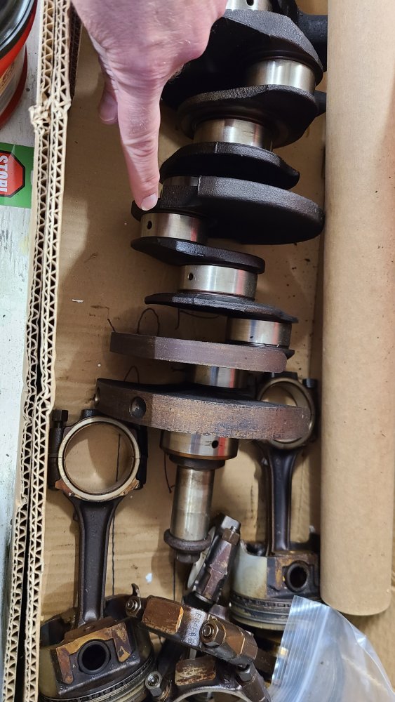

I just happen to have some show&tell items handy.
Here is a crank shaft. I am pointing to a hole on one of the surfaces where a bearing rides. This surface is called a journal. At one end of the crank shaft, there is another hole that lines up with a place where pressurized oil is supplied to it. That oil then comes out of these holes on the journals to supply a film of oil to prevent the bearing surface from actually touching the journal surface. There must be a certain amount of pressure to keep the film of oil thick enough for this purpose.

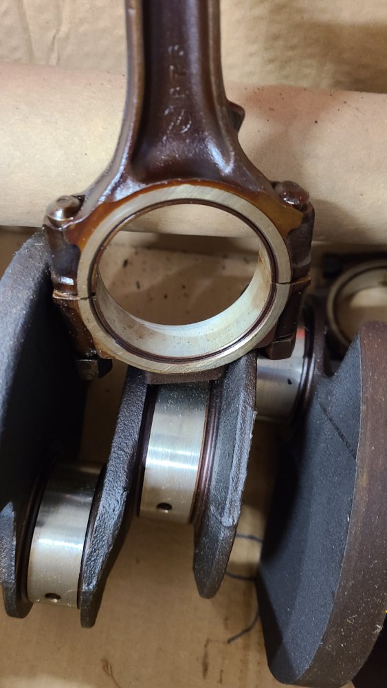

In this picture, I laid a piston rod near the crank journal. Inside the big hole on the end of the rod, a thin piece of metal, probably brass or bronze rides between the rod and the crank journal. That is the bearing that wears out due to lack of lubrication or dirty lubricant. Also, the oil eventually breaks down chemically and can't preform properly. That is why periodic oil changes are necessary.
