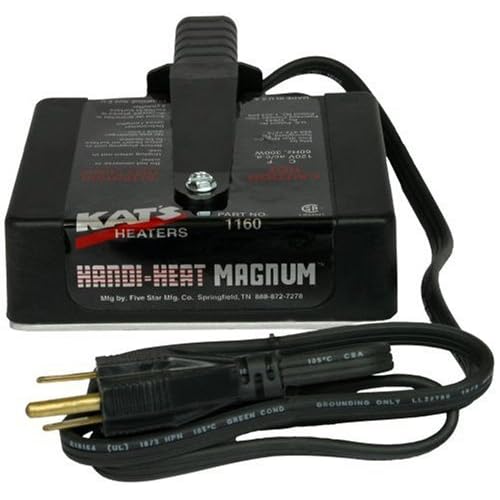

Magnetic heaters: They stick to the bottom of the oil pan or the block and then are just plugged in and removed when you go. some are made to be mounted permanently. come in a few ranges of wattage(300 and 200) surface must be able to take a magnet. Runs off of 110V outlets.

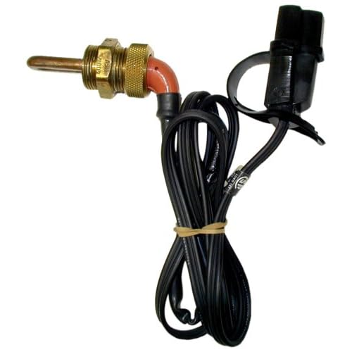

Freeze/Frost Plug Heater: This is the Standard factory method of engine heaters its also the cheapest but hard to install. its a permanent install. Runs off of 110V outlets. Wattages are between 400 to 600 on average.

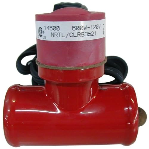

Lower Radiator Hose Heater: this is mounted in-line with the hose and heats the coolant then the block and the oil through that. Runs off of 110V outlet.

Magnetic heaters heat the oil and a small spot on the oil pan, heating the coolant heats everything. We only use them to melt ice in places it shouldn't be (like gearboxes) and gelled fuel tanks.

Doesn't that just bypass coolant flow from the heater core but still let it circulate around the engine? Which would still heat the engine. If that is not the case (I have never really done much with the bypass deal) I would opt for the freeze plug heater, they still work very well at heating up the engine and you don't have to crawl around in the snow to take the heater off before you go anywhere. Some RBV engines (Like the 4.0) have a cast aluminum oil pan which they will obviously not stick to anyway.
