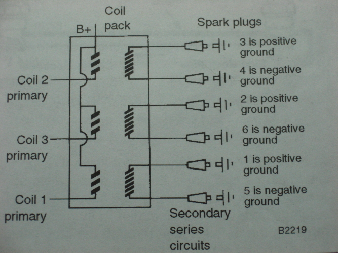

What is ground? In the automobile application, it is a 0 voltage reference point, or a return path for current, or both. The engine is is most always at battery ground if wired properly.
Current/voltage has to come from somewhere, it cannot be generated from thin air without some type of device to do so. The vehicle has a battery to supply electrical power. The battery will have a positive connection and a negative connection. The negative connection in most modern applications is considered as ground. In early automotive designs, the positive terminal was used as ground.
The spark plugs are screwed into the engine block which is at ground potential, and the plug centers are attached to the ignition coil secondary wiring in a series circuit configuration. Although, the coil secondary in the dis/edis system is not physically connected to the block directly, the current path does go thru the sparkplug to engine ground completing the current path.
The attached diagram is from "How to Understand, Service, and Modify Ford Fuel Injection & Electronic Engine Control," by Dr. Charles O. Probst, SAE, page 125. Who is Dr. Probst?
http://www.bentleypublishers.com/author.htm?who=Charles_O._Probst,_SAE
It shows how grounding is achieved in this configuration. The engine block is the return path for current, hence, ground.
Those who are interested, and kinda understand electrical circuits can determine from themselves whether or not there is a ground.

Shady, the only current path from the POSITIVE battery terminal to the NEGATIVE battery terminal (GROUND if you wish) with the DIS/EDIS coilpack is in the primary windings, where open collector drivers GROUND the second primary winding terminal (the first is tied to 12V) which creates a di/dt that induces a voltage into the secondary windings. High voltage is generated
differentially across the two secondary winding terminals and the current flows between these terminals, NOT back to the battery from the engine block!

I didn't say that the secondary connected to the battery. I was simply stating that power has to come from somewhere, and there has to be a complete circuit. This holds true for the secondary circuit in the coil as well. If there is no loop in the secondary circuit, it is an open circuit, and there is no current flow. The circuit is complete as indicated in Dr. Probst's schematic, and he does indicate grounding.:)shady

Shady, obviously you can't read a schematic! The current in the secondary winding flows from one secondary terminal to the other secondary terminal!
I've labeled the terminals + and - Once again, there is NO GROUND reference with the secondary winding, and no current flows back to the battery from the secondary winding. To get GROUND current, the secondary winding would have to have a connection to GROUND (like a center-tap) which it does not have!

I am perfectly capable of reading a schematic. Keep your snide remarks to yourself. Again, I did not say it connects to the battery ground for current flow from the battery. I said the engine block completes the circuit. If the block is not there, there will be no current flow in the secondary winding as it will be an open circuit. The current is generated in the secondary from the collapsing magnetic field of the primary winding. If there is nothing attached to the secondary winding for a load, there will be no current flow. If there is a load, but the circuit is open, there will be no current flow. Being that the part of the circuit that completes the secondary winding loop is the engine block, this could be considered ground as it is fixed and does not change. If you don't mind, I will go with Dr. Probst schematic and not yours. And why all this is such a big deal to you:dunno::dunno::)shady
In a sense, you're both correct - in the Ford EDIS setup, the block only serves as a 'path' to complete each secondary circuit whereas, in 'most' of the other engine circuits, the block is a physical grounding point of the negative battery terminal. In the single coil systems the block is the actual 'ground'. In modern vehicle electronic control systems, the ground from the battery is usually provided through the pcm to trigger events such as injector firing, coil primary pulsing, etc.

Correct Bird, the injector coils are fired very similar to the coilpack primary windings.

Correct, and in the conventional coil system, the coil is an "autotransformer." The primary and secondary windings are the same wire. The winding is tapped at some point to ground to make the primary and secondary circuits. As indicated in Dr. Probst's schematic, the block serves the purpose of completing the circuit, and has 0vdc, satisfying the definition of a ground. He designates each plug as positive ground and negative ground.:)shady
