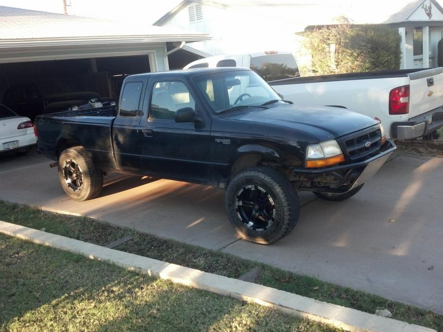

Picture of the beast LOL
camburg 5.5 kit up front, mix and match leafs in the rear, 265/75/17 toyo open country 1's on bargain bin 17x8 wheels, tube front and rear bumpers with a flimsy aluminum skid plate. Bought the truck from a retired couple who pulled it around behind there RV, the bedsides show it from all the rock chips but I got a nine inch to throw in pretty soon so the bedsides will get new fiberglass anyways.
Just wish I had more time to drive it....... Sadly I have put less than 5,000 miles on it in 2 years I have had it.:dunno:
