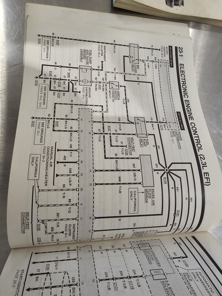

I hit a big pothole yesterday and now my oil pressure gauge and my temp gauge went out. The truck started running odd. Got it home shut it off now it won't start. It cranks but won't run. The msd 6al is getting 12 volts the coil doesn't seem to be getting 12 volts. the light flashes 5 times on the box when I turn the key on. Which supposedly indicates the box is working. It's getting fuel I can smell after cranking. It's a 90 2.3 dash harness and 90 5.0 mustang a9l and harness. I would like to make the show on Saturday. Does anyone have those wiring diagrams and ideas? I ordered a new coil and msd box but they only come Thursday.

Those guages on Ford's are kinda like dummy lights. I could get a real sending unit and mechanical guages, (atleast oil pressure anyway) but I'm not sure where to look without the schematics and I can't find them in the library for pre 93 I think it was. I gotta keep looking on line.
After almost an hour at Mcguire Ford taking pictures of most of the pages of the master wiring book for a 90 mustang and 90 ranger. Then two hours of poking and prodding, The truck is fixed. The salt shaker came unplugged on the mustang harness..... of course it was something simple and thankfully it was. Also got the alternator swapped out for one that doesn't fluctuate like crazy... autozone parts are getting worse.
Found the box online but won't be here till next week.... or the next but I got alot of pictures also.
