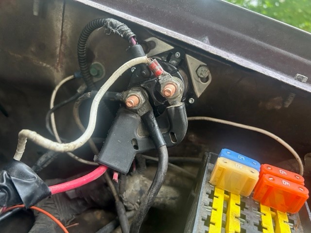

Let's start with the fender mounted solenoid. Replaced the solenoid and put the wires back exactly how I found them. Note the cut red wire at the bottom.

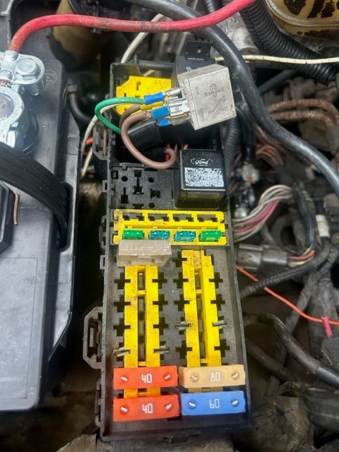

Then there's the fusebox
All fuses have been replaced. But that relay doesn't look welcoming whatsoever.

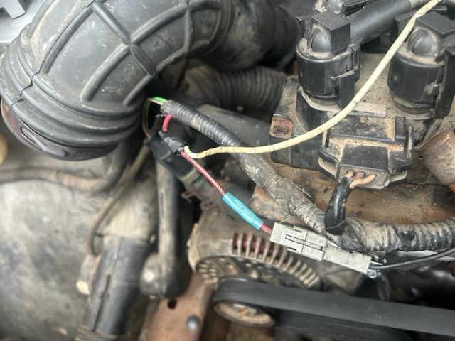

That white wire runs freely across the engine bay to here

Have you checked, and tested ALL of the fuses in the underhood fuse box? Using a meter, for power by probing the small openings on the top of each fuse. I note that you say the fuses are new, but we want to know where you have, and don't have, +12 volt power.

Not really. The power wire, at least, is not OK; part of it is cut.
Your solenoid does not look like it's configured right. Off the top of my head, here's what I think you have going on. There should be three "battery" wires (constant +12 volt) at the solenoid (relay, actually): 1) the thick red is from the battery + post; 2) the thick black wire feeds the underhood fuse box; the smaller wire coming off the terminal at 9:00, looks brown but is called out as gray, goes to the charging system.
The small brown wire looks like it's toast because of the discoloration at it's ring terminal. This wire connects to the alternator for the charging system, The white wire that "goes across the engine bay to here" in your fourth picture may be related to this.
The white wire that was added to the upper right solenoid (relay) terminal likely goes to the (real) starter solenoid, on the starter motor itself. That is what the cut red wire would normally do.
That's just my opinion, just looking at pictures, and working from memory so take it with a grain of salt. I'm sorry; I know that all of this is likely hard to digest, all at once. Please study your wiring diagrams, and compare it to what's in the truck.

The first thing I'd do, is to determine if power is in the underhood fuse box, then why if it is not. The fuse box can be unbolted and turned over (disconnect the battery, remember?) for inspection. Corrosion in the electrical connections there, is very common.
