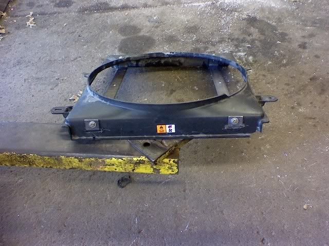

Yours look like what I did to the Ranger shroud without the efan brackets.
Sorry that I can't share my pics of efan install. Fits really good.
It's better to use the factory shroud for mechanical support
and to funnel the air to the efan than just using the brackets by themselves.
