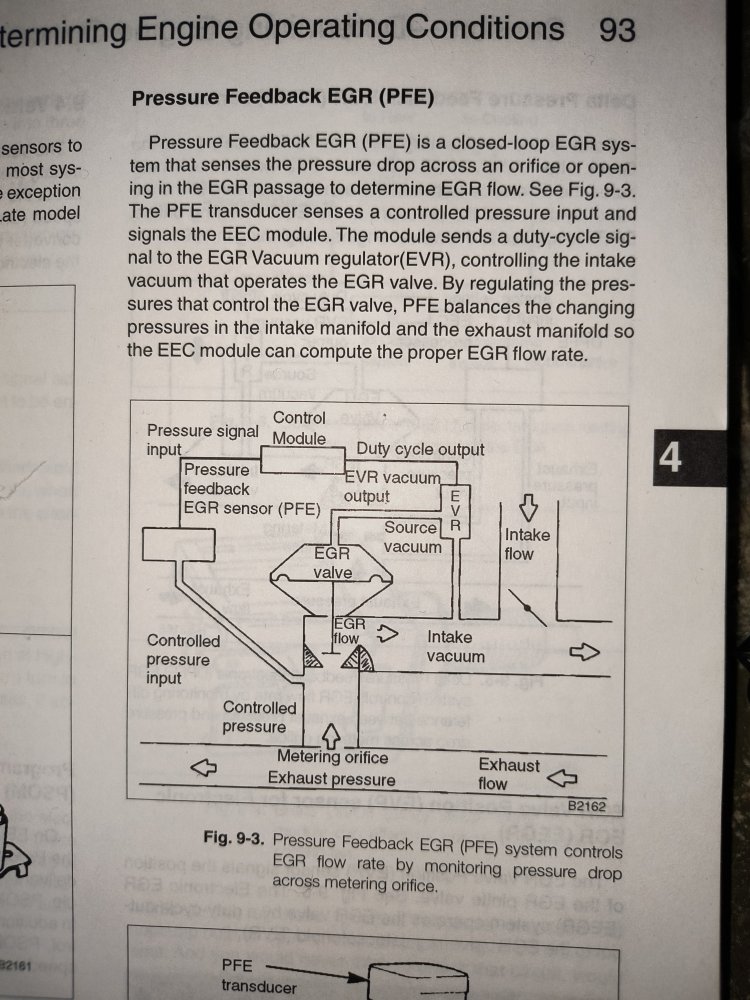

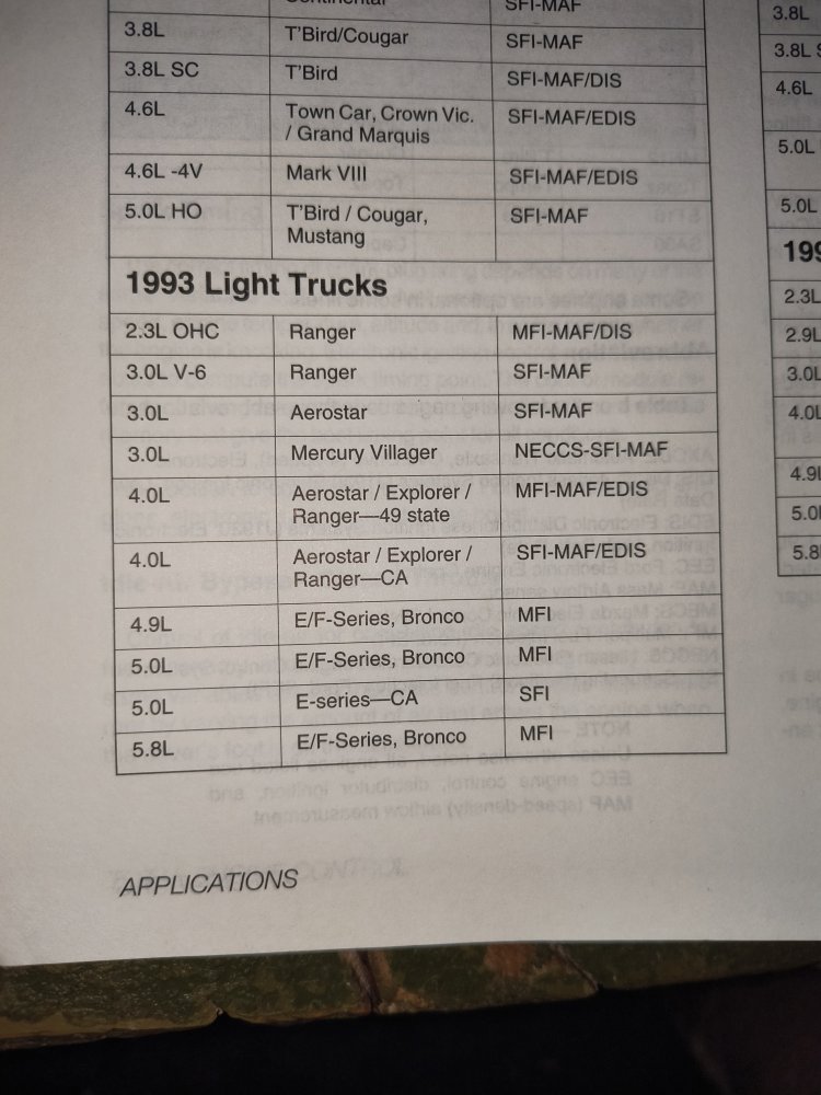

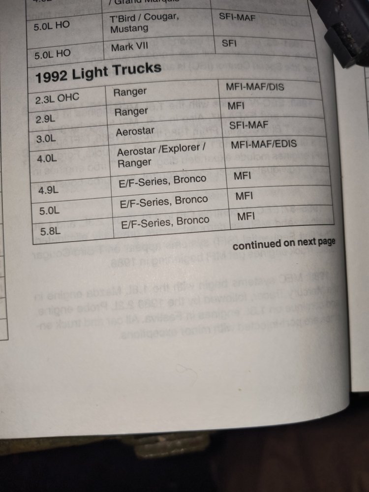

Here is the text from the document, FORD FUEL INJECTION & ELECTRONIC ENGINE CONTROL by Charles O. Probst, SAE.
The first 2 pics support that SFI was available in 92 but only with the 3.0l and that starting in 1993, the OHV 4.0l came in SFI (with EGR, the California emissions version) or MFI (no EGR, Federal version).
The following 3 pics with associated text explain the general function but do not clarify precisely what the PCM does with it or exactly why.
The first 2 pics support that SFE was available in 92 but only with the 3.0l and that starting in 1993, the OHV 4.0l came in SFI (with EGR, the California emissy version) or MFI (no EGR, Federal version).
