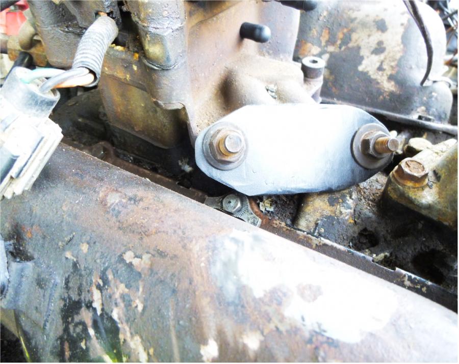

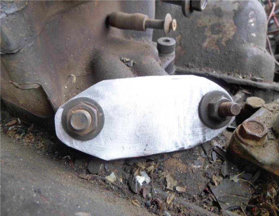

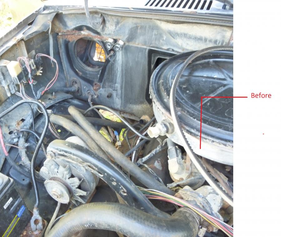

Just to give an update. I ended up cutting some metal off an old riding lawnmower. Cut it to shape. I used the EGR valve as a reference to mark then cut. I then used a table grinder to smooth the edges and grind the paint off. I then primed it and painted it with 1200° paint. Here are some pictures.
