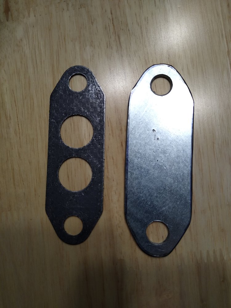

If you have an angle gringer, a multi-step drill bit and a EGR gasket from Autozone you can make one out of a 4x4 electrical junction box cover plate from Lowes.
See the block of plate I made in the picture.

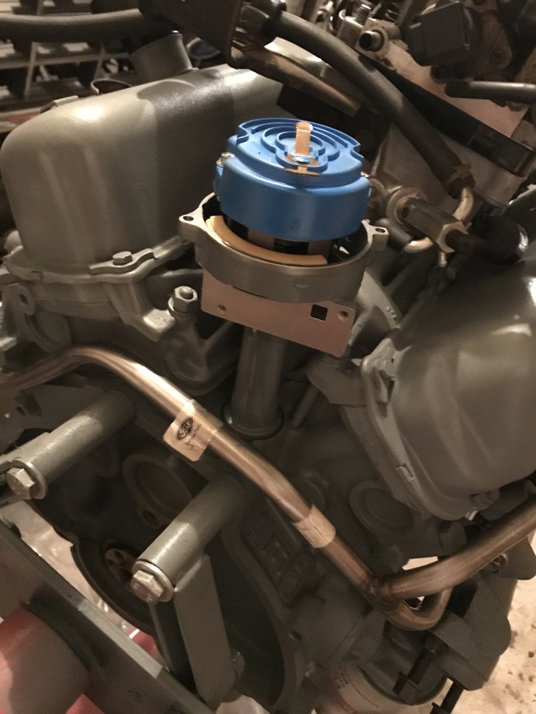

Sure, if you go to auto zone and ask for an EGR pipe, they’re not going to be able to supply the AIR injection tubes. ‘65 mustang would have had points, but the 2.8 didn’t come along until ‘74. Duraspark is a last ditch effort to get things running when too many items in the EEC-IV system have been removed/damaged. It’s by no means an upgrade.

I want to compliment you on the excellent picture of a 2.8 on an engine stand with a view of the AIR pipes you can't possibly see when the engine is in the truck. The Ford inventory labels are excellent proof that the AIR pipes are available. I am now aware of my erroneous statement that they are not available.
This is the block off plate I made from a 4" x 4" junction box cover from Home Depot.
