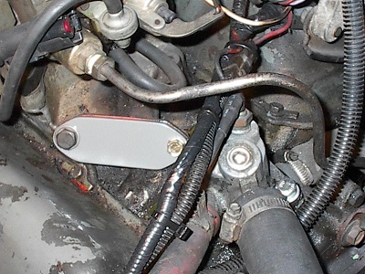

This is for 90's model 3.0l's, but yours would be remarkably similar.
It should look about like this.
And bolt on here, in place of the EGR valve.
Since there won't be any exhaust gas flow, heat is not an issue. A simple gasket or good quality liquid gasket material should work. A chunk of steel or aluminum 1/4" or thicker with a really flat sealing surface should work great. 30 minute project with a hack saw, drill and file.

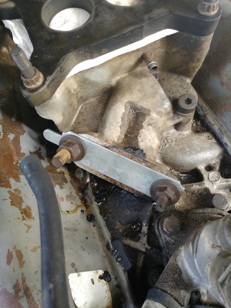

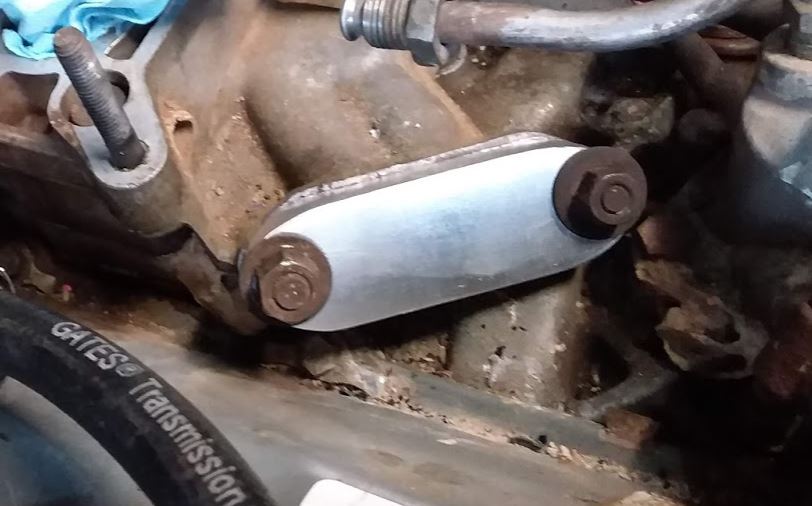

This is what I have... Im wanting to block the EGR. Since I dont have ANY of the original ignition stuff. Its the duraspark system.
Use what you have there as a pattern to make a new one out of thicker metal. That piece leaks because it is too thin and flexible.

Mine looks very similar to the one pictured in the next post. Yours looks way to thin, that's why it leaks. Needs to be thickerer. I don't think any EGR valves, where that part mounts to the intake, are any different. The one on my 98 Ranger looks like it would fit my 04 Lightning and 07 Mustang.
That's exactly what I did on mine. The starter shim is too thin, and I'm surprised that it worked as long as it did for you. Scrounge up a piece of flat steel, and then hack saw, drill, and file on it until it looks like this:

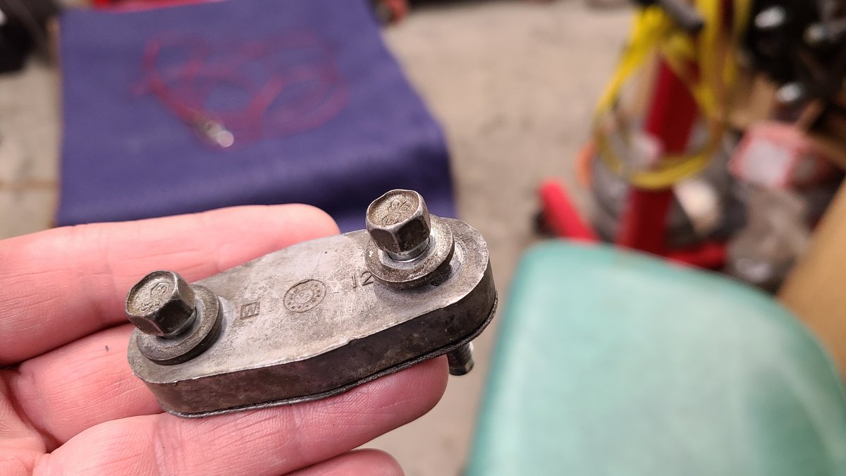

You need a thicker plate like mentioned. I took my gasket to work and had a buddy in the shop make me a plate.

I took an electrical junction box, 4" x 4" cover and traced the FEL Pro gasket on it and cut and drilled it to be slightly larger than the gasket. This is a heavier metal that what you have in the picture.
