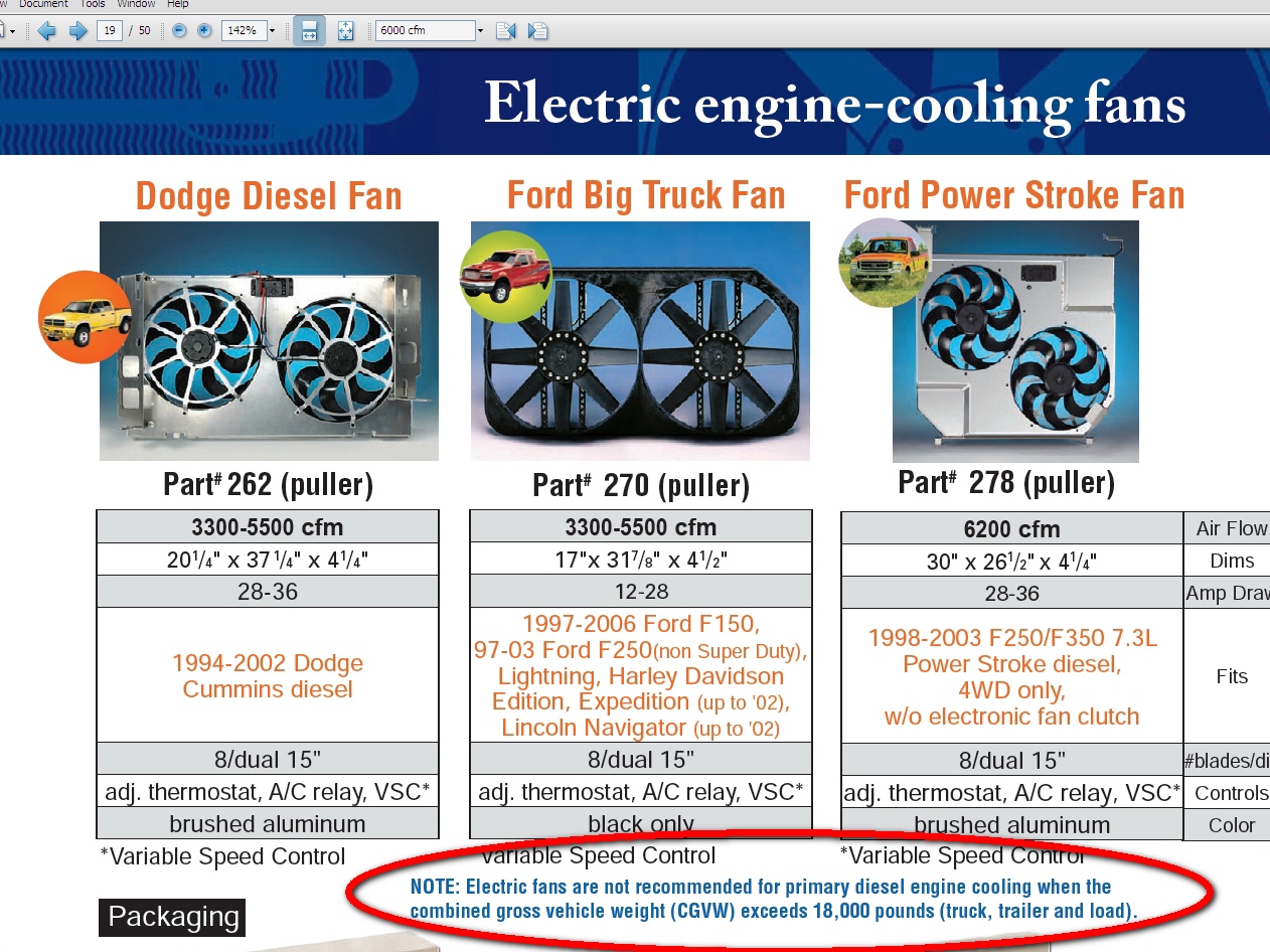

Even aftermarket e-fan manufacturers don't recommend their e-fans for primary cooling with heavy heat loads:
The only reason I am pointing this out is because I didnt see where any one else has. In the red circle that I assume you put on that pic, it says not recommended when CGVR is over 18,000 pounds. I am in no way trying to start anything. It does seem that some folks are set in their ways. I think at this point it wouldnt matter if you were proved wrong that you would admit it. Some people cant help that they are narcissistic a$$holes
