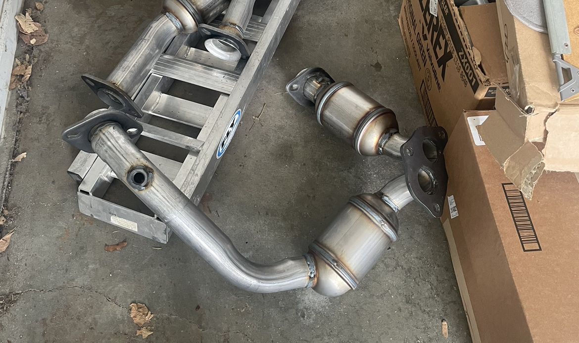

UPDATE: Got the exhaust pieces in the mail today! Nice quality, esp for the price. Only one cat has honeycomb in the cat pipe. There is a bit of slag on the three-hole flange, but that will clean up with no issues. Question: what quality bolts have yall used? 316 stainless? 17-4 pH? I hate rotting bolts...

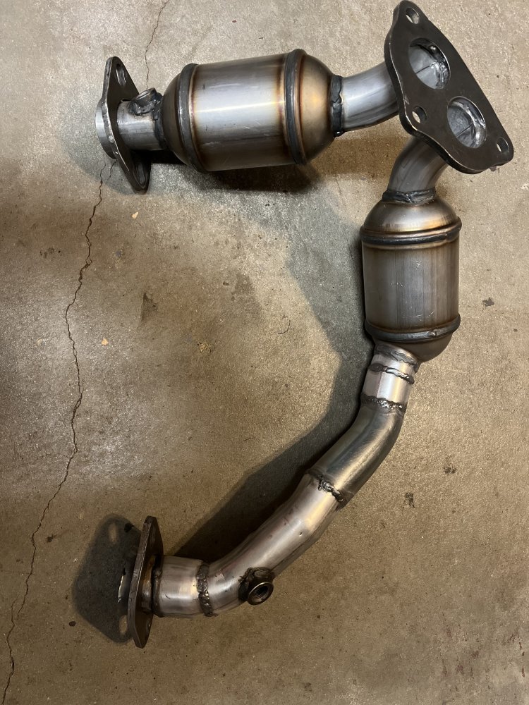

UPDATE: The headers had some issues. Driver's side went on easily. The dipstick tube had to be bent a bit to work, but no biggie. The passenger's side collector to y pipe flange had to be trimmed so it didnt hit the oil filter mount. Additionally, the flange at the primaries had to get a couple U cuts in order to make clearance for the sparkplugs. The y pipe is definitely not working. I am having it towed to an exh shop so they can finish my exhaust. A flowmaster super 44 will finish it off and be dumped under the bed.
sounds like it will be loud when its done.

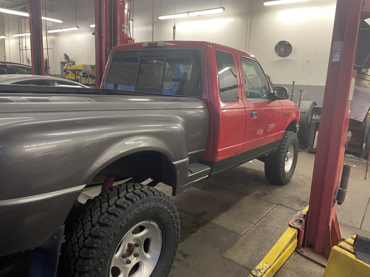

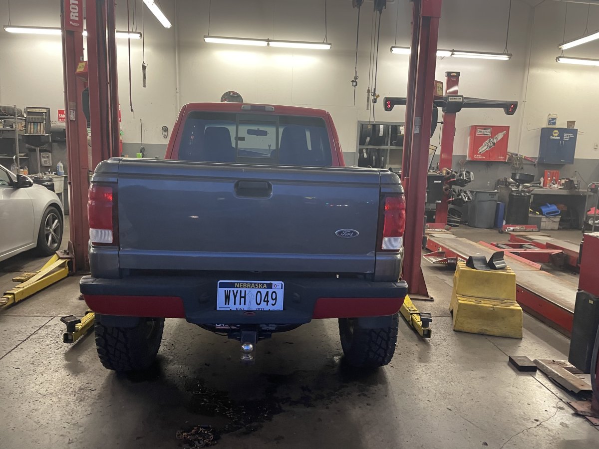

Well, the y pipe from ebay was nice, but it turned out ro be too narrow. My exhaust guy is whining that he doesnt wanna mod it to make it work (my window for return is closed). He will supposedly make one for me. Other than that, here are some before n after pics:

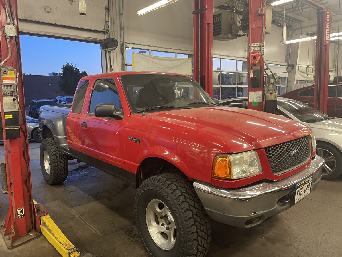

UPDATE: my buddy agreed to help mod the y pipe to make it work. Countless scenarios of install/drop/cut/tack, re-install, but the y is installed. Once we figured out how to make it wide enough, we had to find a route around the driveshaft. Before n after pics:
