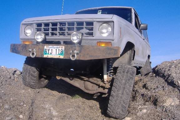

I agree. This is a 21" long coil. The lower bucket has a 1.5" spacer under it.
The beam will drop further. The rotors were sitting on the ground.
Right now the front mounted shock is my limiter. Once I get the 14" travel one in place It should then become the spring. One day when I have the $$ and the right parts come along.....................
The front shocks were stopping any further movement. damn 12" stroke shocks.

I can easily fit a 24" long coil in my setup maybe even longer. Again the upper coil buckets I used are F150 TTB buckets. And they are 3" taller than the RBV bucket.
If he plans to use the stock RBV bucket that is 3" less room he has to work with.

The front travel I have is pretty even right to left.
This is with a 235-360 coil

The lower bucket is only1.5" higher. the upper is 3" Right now I can fit a 24" coil easily without the lower rise. 21" easily with the rise.
23" with rise may be tight. 23" without rise will be fine. Now lower that with the RBV bucket......Spring compressor time. i'm only using the 4" pivots. I could go more with the 6" pivots but I don't want to. 5.5" lift is more than enough.....if not too high.
