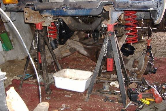

FWIW, I'm just finishing up putting some 22" long coils into mine (SJ #JC60F). I raised the buckets up 2" and they easily dropped right in, with maybe an inch to spare. My axle brackets are 2.5", so this would effectively be the same as a 4.5" lift.
I agree. This is a 21" long coil. The lower bucket has a 1.5" spacer under it.

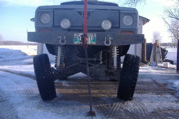

The beam will drop further. The rotors were sitting on the ground.
EB Coils - think I found the unicorn
Right now the front mounted shock is my limiter. Once I get the 14" travel one in place It should then become the spring. One day when I have the $$ and the right parts come along.....................
The front shocks were stopping any further movement. damn 12" stroke shocks.
