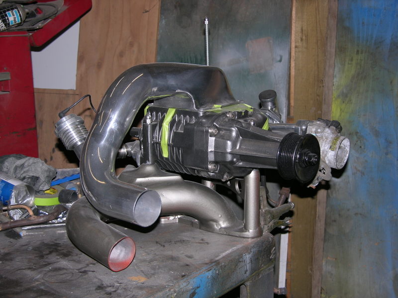

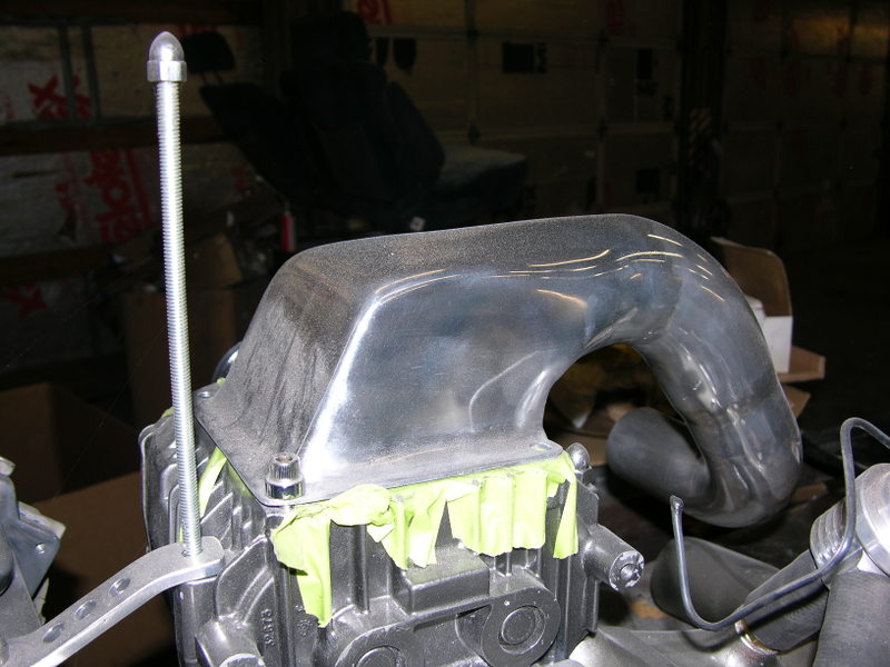

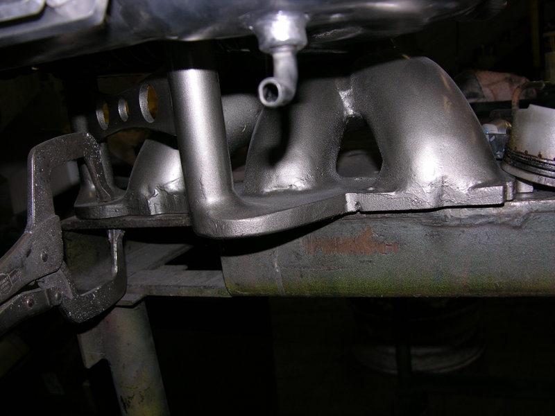

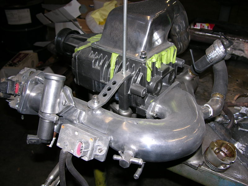

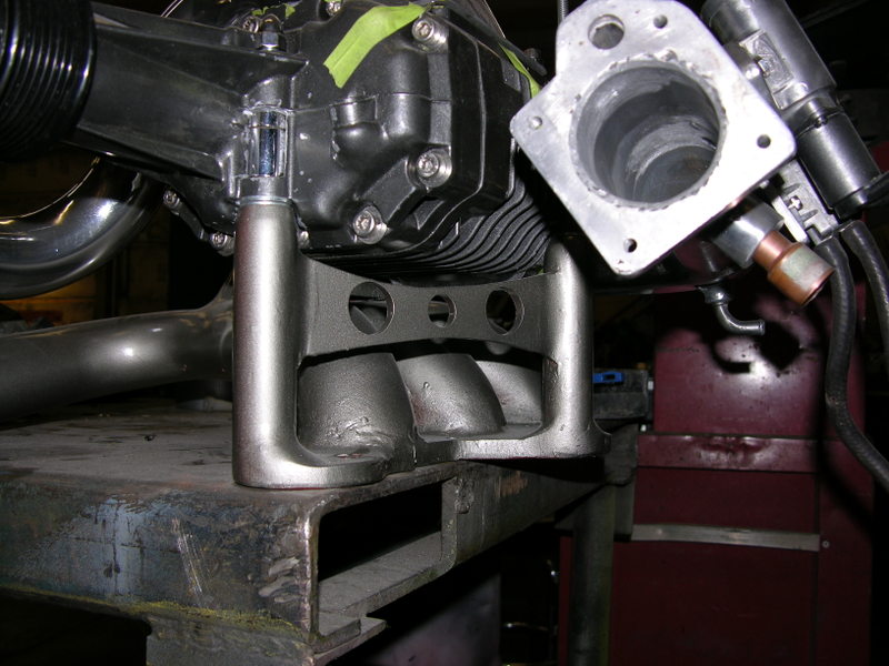

Just run the SC off to the side so you can use your stock intake and then hook up an FMIC.
Some pictures that I have collected over the years. I've got more I just need to find them.
