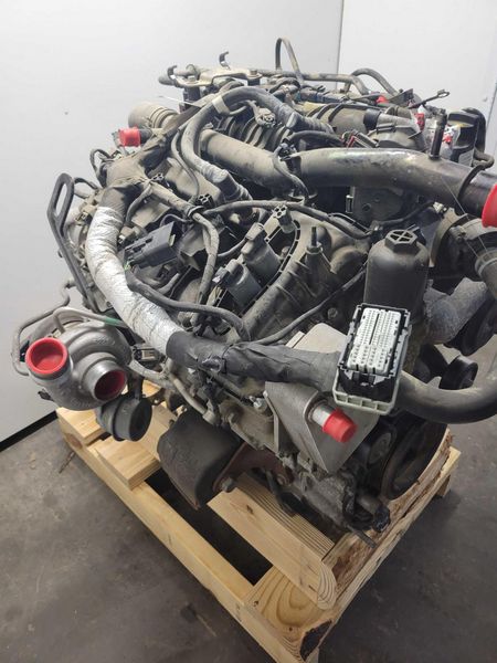

3000 for this one over at premier in westland 102k miles.
