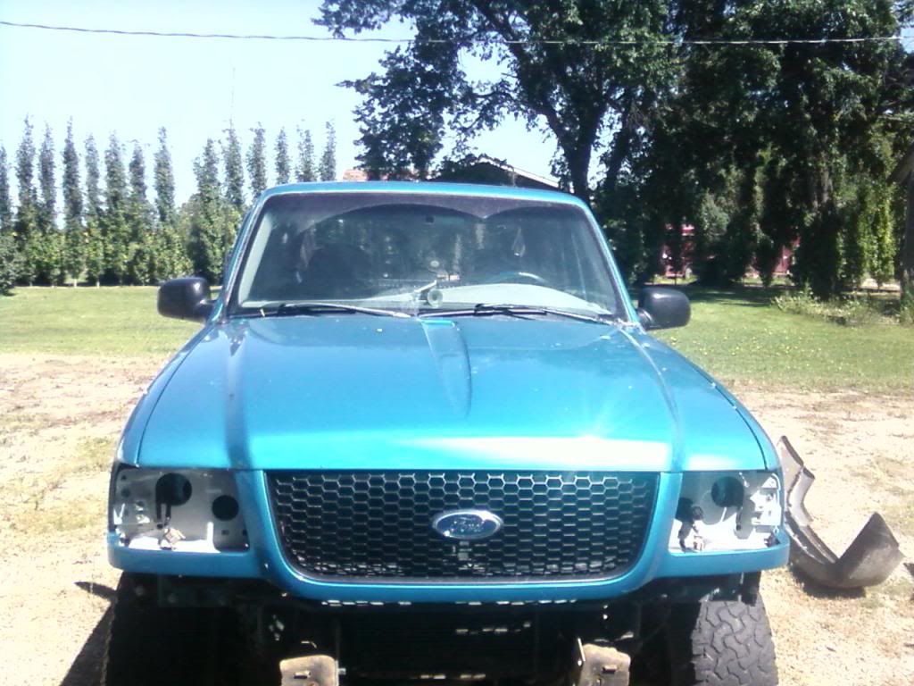

I've been messing around with adjusting the body lines on everything so much. Probably at least two hours today. Also did this today:
The fenders are still low and a bit out. So I am going to build a lil bracket that pulls then in and up a bit and then attach it to the core support. That will pull the header panel up and then it should look normal, right now in this pick the header panel is just attached to the two fenders. Hood latch for this this is going to be INTERESTING thats for sure

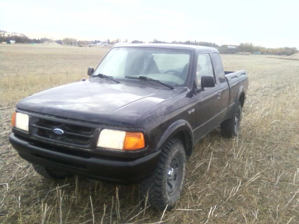

Check it:
Finally got it done. Hood latches are working on both of them. Made some header panel brackets for the blue one. I am waiting on the headlights for the blue one. I will make brackets for the blue ones bumper soon hopefully. And its looking like I will need to build a custom bumper for the black one :boggled:

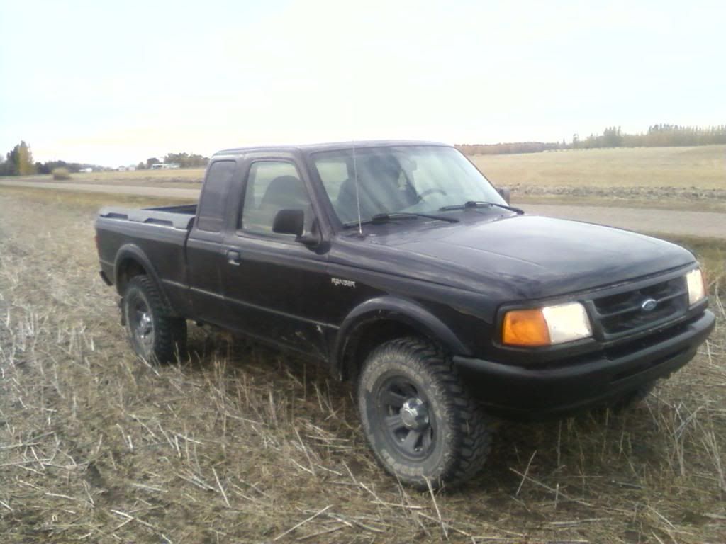

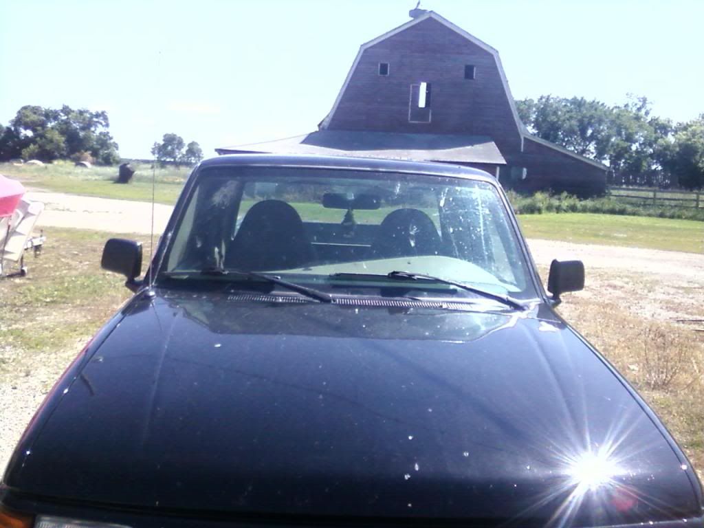

Haven't built a bumper yet for the black one and haven't got my headlights yet for the blue one...frick...but I did swap the mirrors:

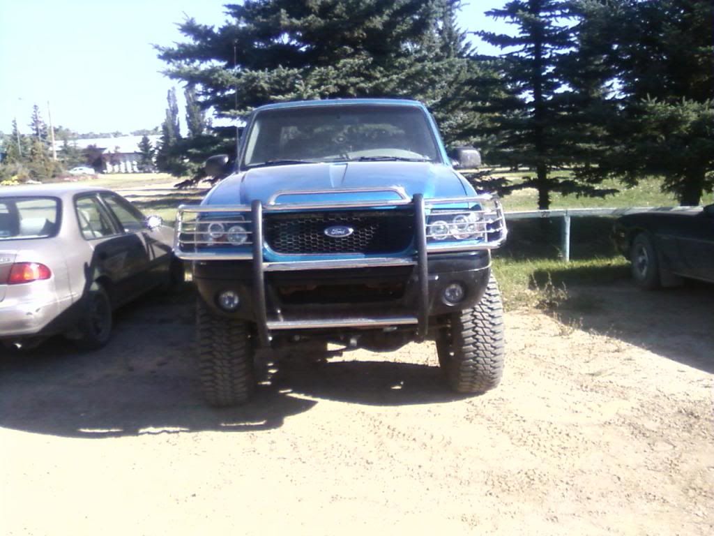

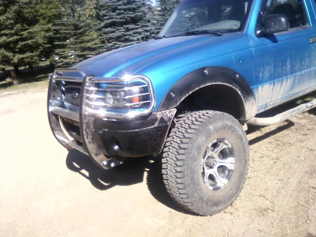

Hey guys. I got busy with other things and forgot about this thread (sorry :icon_twisted:). As you can tell by the pics, I finally got everything done:
and
The pushbar is a little crooked...I will get that fixed. Haha
Hope you enjoy. Any questions just ask
