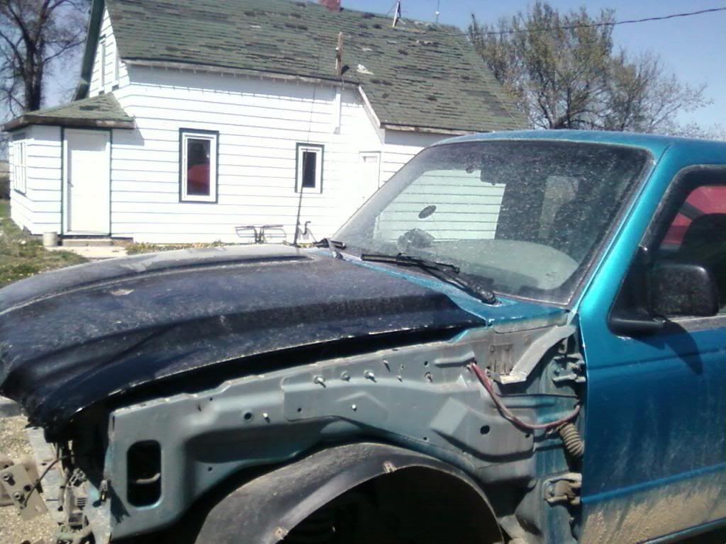

Thanks man, because yeah the core support is holding me up right now :sad: and of course I will swap the hood! Sexy powderdome...I am just leaving them on for now until the last moment so I can close them overnight so the engines and everything don't get rained on

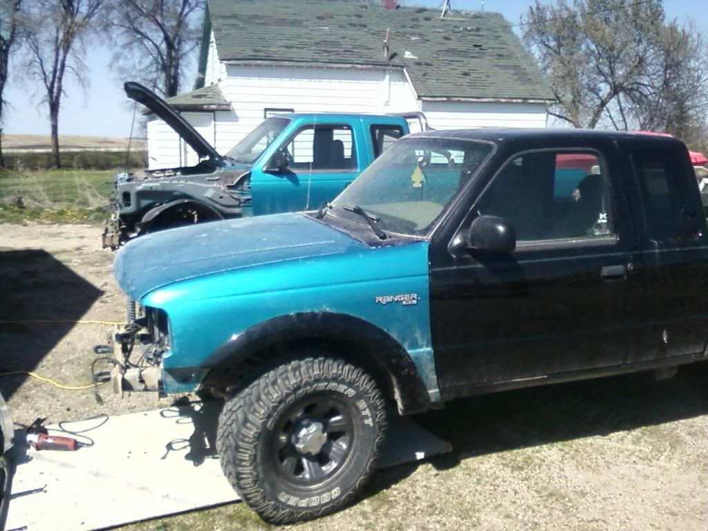

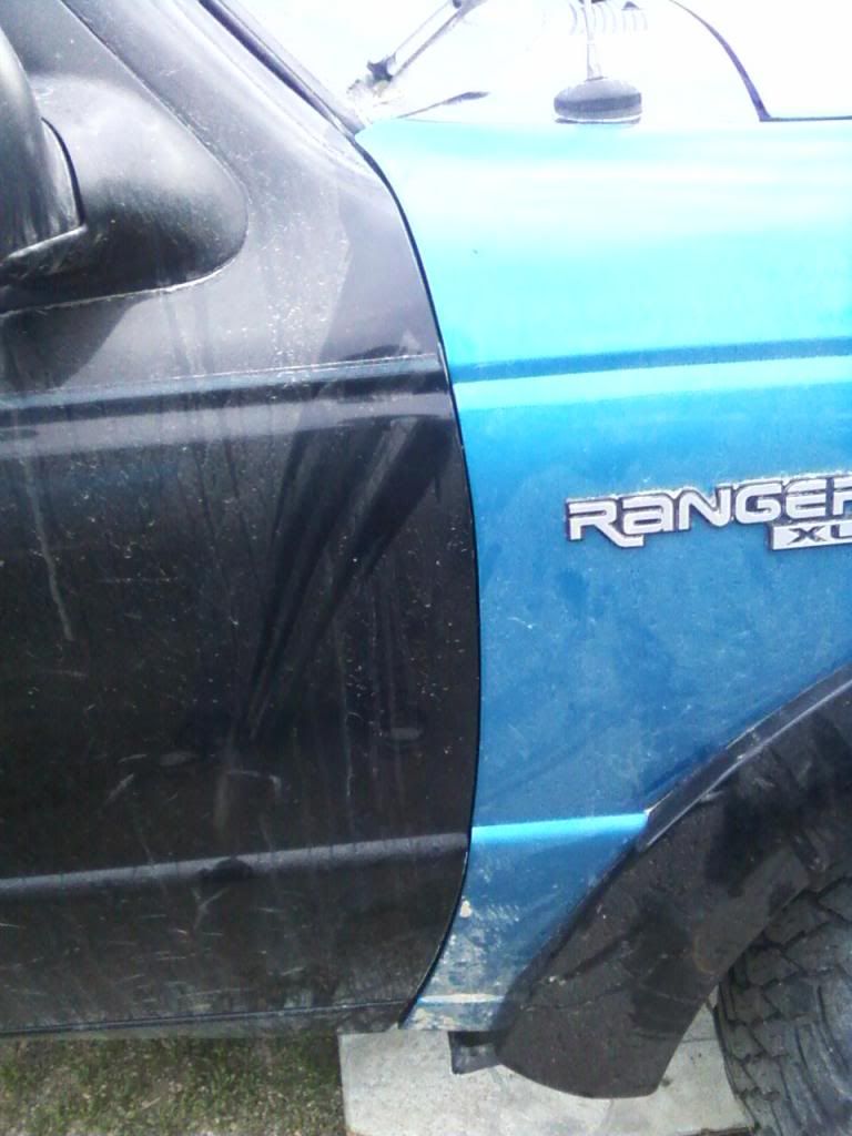

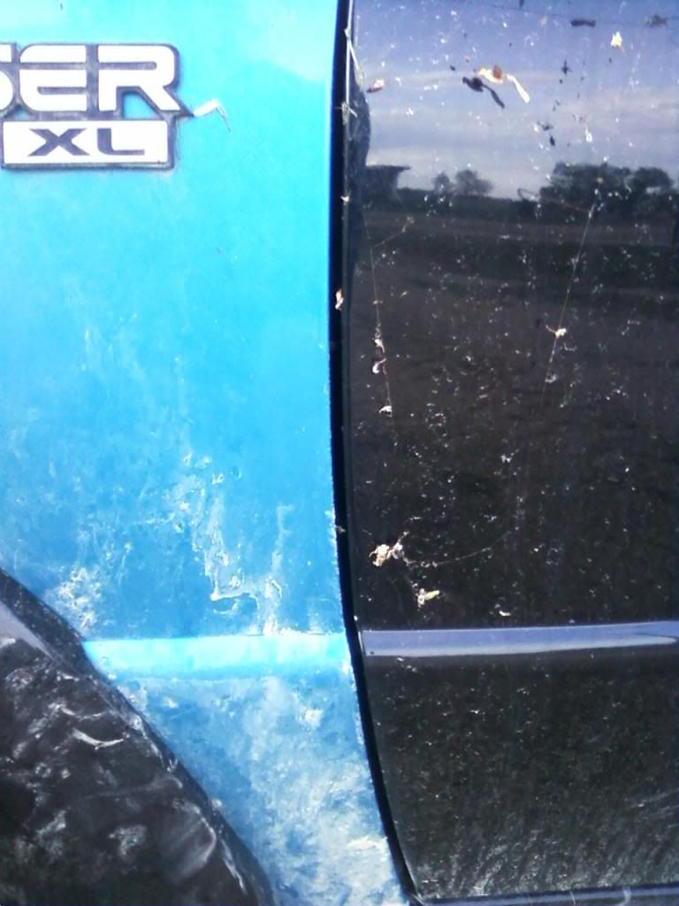

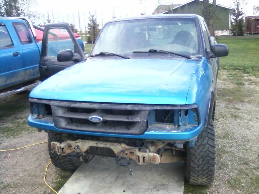

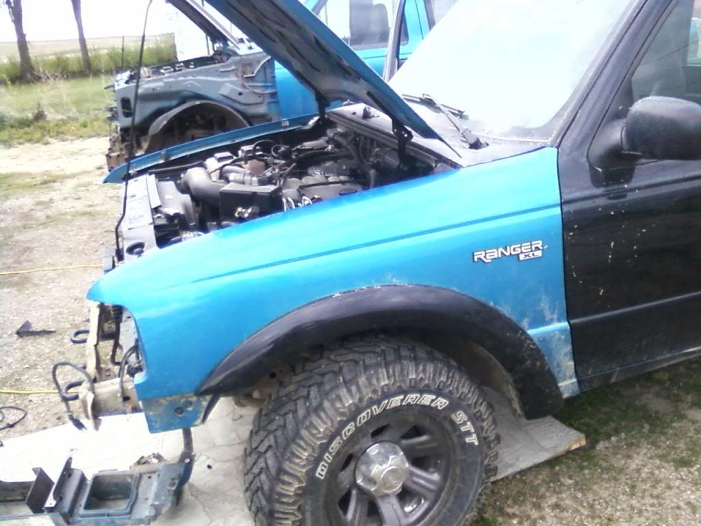

Well decided to leave the core supports. Thank goodness I did! Its not even hard. I am such a noob...bolted the fenders on the 2001. First two holes lined up so I just did those and the one by the door and the one on the bottom fender, also the brackets worked just fine in the front so also bolted those on. Fenders looking good, also swapped the hoods today (maybe yesterday..I dunno...hoods got swapped at some point
Some pics:
Sexy Hood:
Fenders and Hood Swapped Over:
Fender...works and stuff:
Also spent yesterday putting this bad boy in...one piece!:
Also spent most of today getting this thing running...haha:

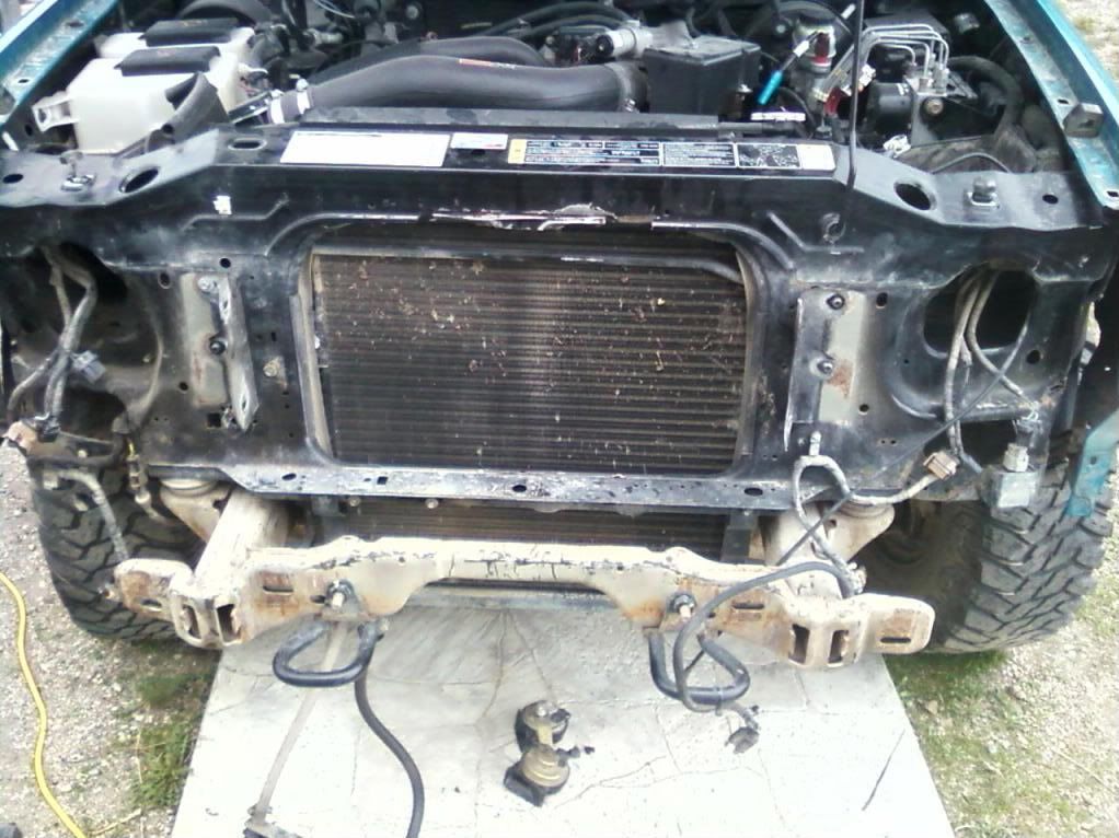

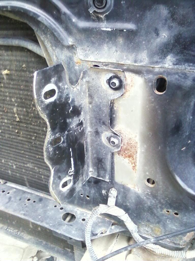

Had to modify the core support a bit to clear the 1996 header panel, I cut out the middle bit and also trimmed around the top so it would snug up, and I trimmed and flipped the brackets:
Ended up looking like this:
Managed to get the header panel bolted on semi tight and ended up with a truck that looked like this:

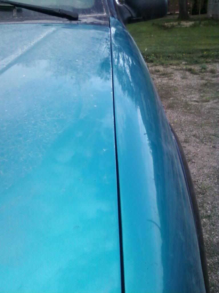

Lines are looking not bad:
I am still going to jiggle to hood around to try and get it looking a bit better, and the doors have to be moved back ever so slightly. The bumper will go on next and hopefully that will not be too hard. Then I have to figure out the wiring and get the lights working some how??? Also I will have to do some custom work on the hood latch mechanism
