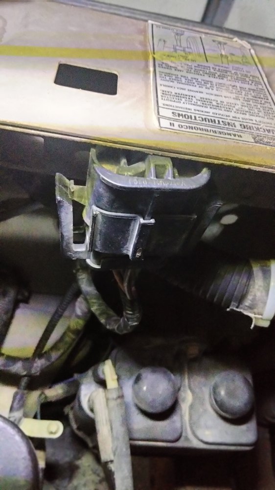

Easiest way to tell, look right behind your drivers headlight, if you see a horn (the loud thing to warn traffic) you are not wired for DRL, if you see this:
with a little "dummy plug" on it (no pic, sorry) then you are wired.
A canadian vehicle would have a full DRL module there - go to rock auto and look up these part numbers if you want to see the pix.
Rock Auto lists a DRL module for 1990 Ford Ranger 2.9L XLT - part number Standard Motor Products LMD100 OR (Wells) WVE 6H1475....
OEM / Interchange Numbers: E9SZ15A272B, F43Z15A272A, F7LY15A272AA, FODZ15A272B, FOTZ15A270A
7 of the 8 pins are wired on that connector.
The USA dummy plug connects the high beam indicator lamp to the high beams, and has 2 other pins that I can't figure out what they do by reverse engineering. If you have the plug and want all that I have figured out I am glad to share it. (people also refer to this as a dummy resistor, but I found no resistance... I think it is because the real module has a resistor to reduce the low beams to a dimmer setting when running as DRL or bypass and go full bright when used as headlights)

I found my pic of the DRL Dummy module as I found it before I touched anything:
