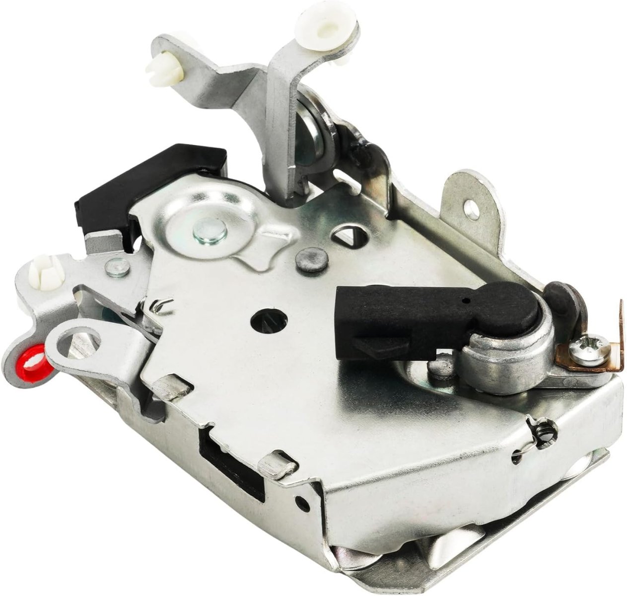

This one:
Or this one:
For the price, I'll replace both since I'm already scraping the snot outta my hands digging around inside that tiny space :p
The first is the locking mechanism, the second is the actuator.
Thank you gentlemen, much appreciated.

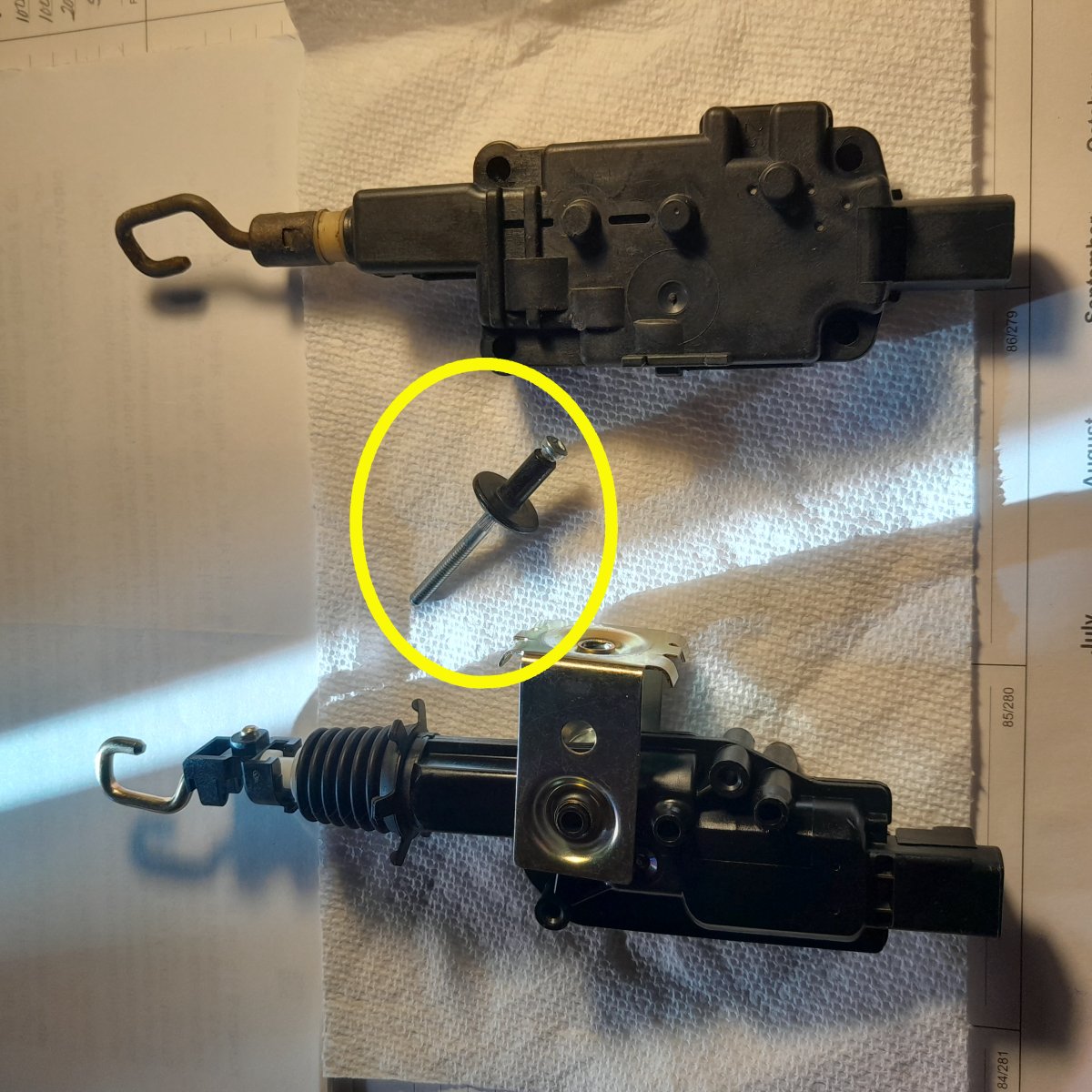

The actuator came today from Rock Auto. A few minor differences in the structure.
It did come with what I think is a pop rivet to fasten the actuator to the door panel(?)
At least that's what it looks like. The original uses a bolt which is what I am going to use on the new one.
Thanks for your help. Hopefully tomorrow, weather permitting...
