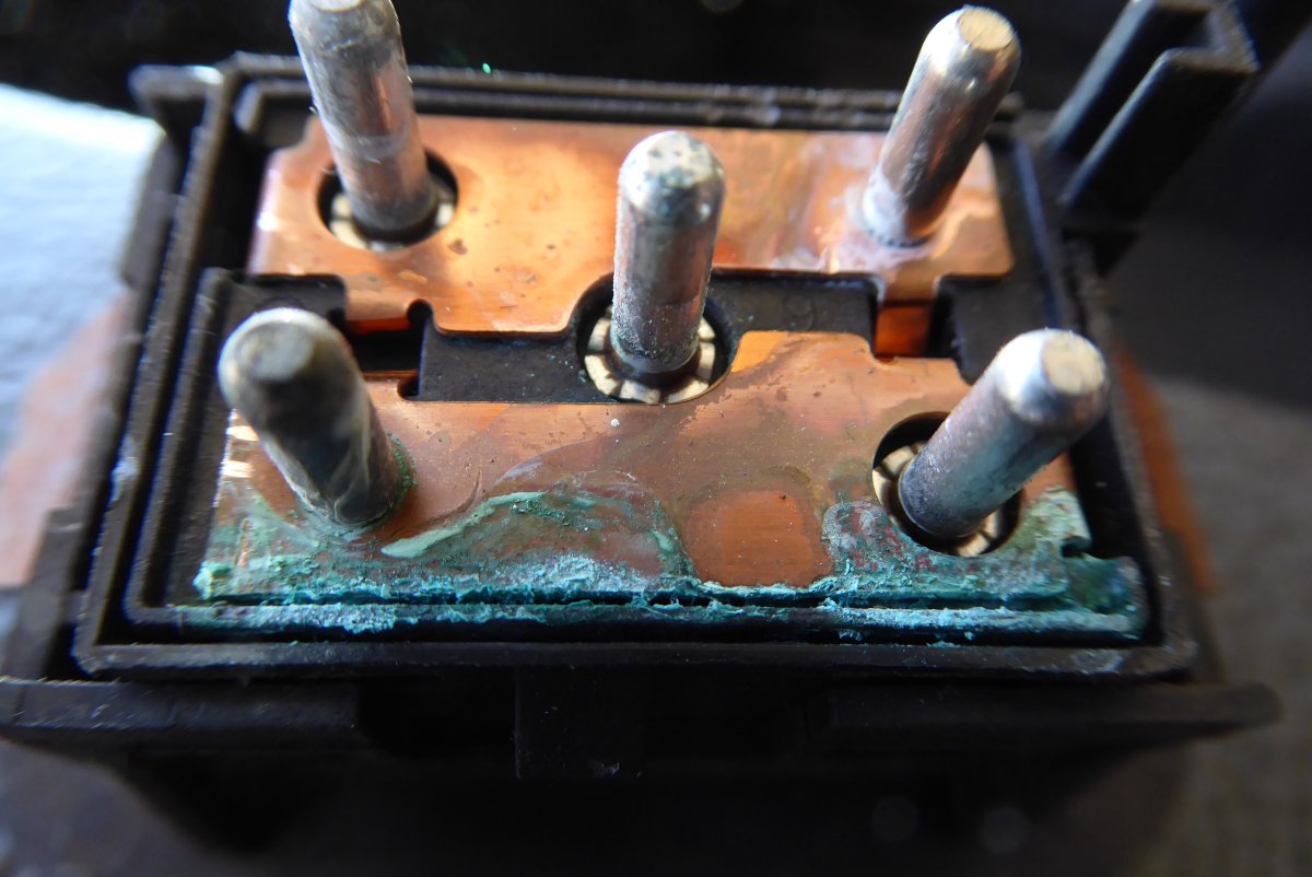

My drivers side window switch stopped working for both windows. My problem turned out to be high resistance contact at the switch due to corrosion buildup at the switch. I cleaned it up, sprayed it with contact cleaner and it's been fine for over 2 years now.
Wow....my was squeaky clean but dusty. Sprayed it down and polished it up.
