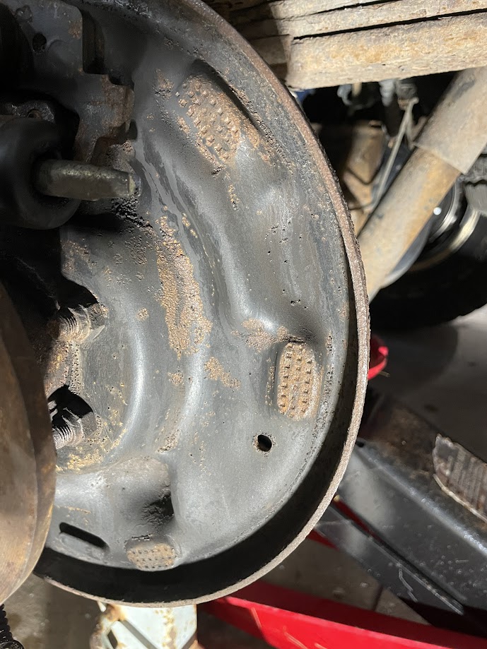

#2, I did find a shallow groove in the backing plate where the shoe contacts it but only on one of the little pads. I smoothed that out with a flap wheel.

Normal looking:
This one had a visible groove worn in it.

Your groove doesn't look that bad... but it might have been enough.
The other side had a groove that was worse but it wasn't dragging so I guess I'm at a loss as to what exactly caused it but am not complaining either.
