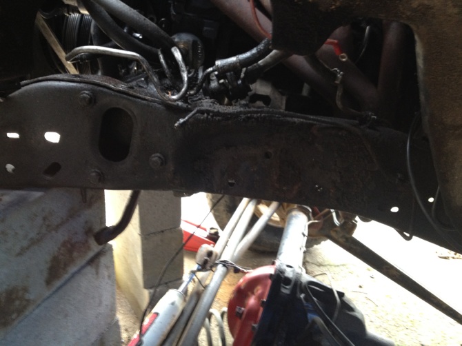

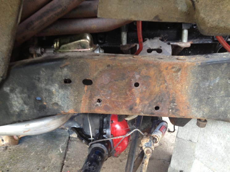

on my ranger its got a a hump on the drivers side frame side from the power steering box (outside of the frame ) how do i eliminate the monting problem of it not monting flat ill post pics
the flat one is the passengers side frame

I/We STILL dont understand what youre trying to do...
When I put EB coil buckets onto mine, I cut and reshaped the back of the bucket to fit over the hump in the frame.
im thinking about just welding some shims in to make it flat and drilling the holes threw to mount the bracket but other than that i dont know what to do to fix it
I just told you....
^^^This!!! I've got some after-market spring buckets that I'll probably notch to fit around the bump in the frame. If you start shimming things out on the frame, you'd better do the same on both side or it'll be uneven.
i see what your saying now ok thanks for the advise im gonna go get stated on it right now
