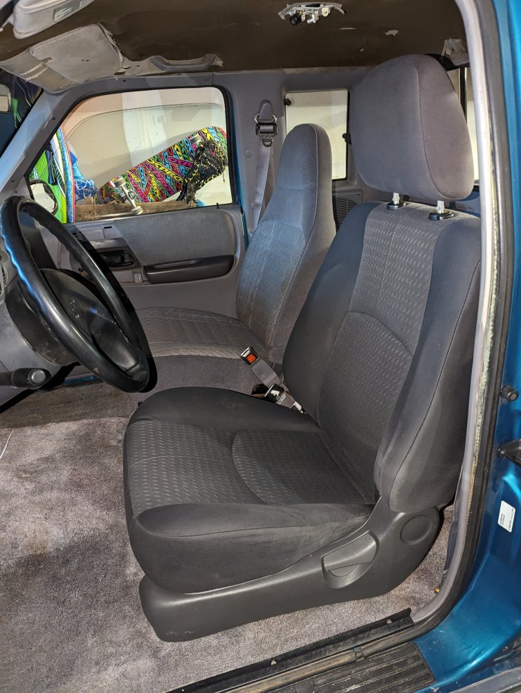

I found a set of buckets out of an 05 Mazda CX-5 (i think???) that i was able to modify (flat stock steel strap) to work for now. almost ANYTHING will work, just depends how much you want to modify it. My only complaint about my modified seat is that it doesn't 'flip' forward enough for someone to squeeze into the rear easily.
Here's what mine currently looks like:

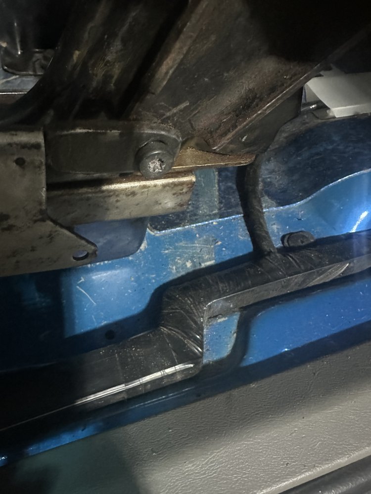

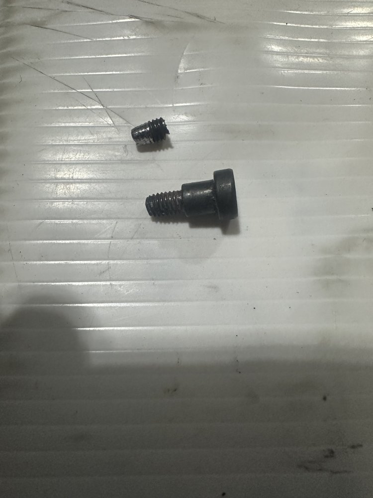

After disassembly I found two broken bolts. One on each side of the seat. They connect lower part of back rest to the spring loaded adjuster. Should be easily fixable. Seat foam and fabric is tired and gross. 25 years of ook. Not sure it’s worth it. It will have to do until I find a better option.

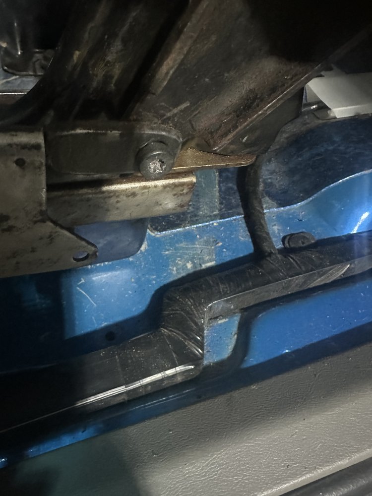

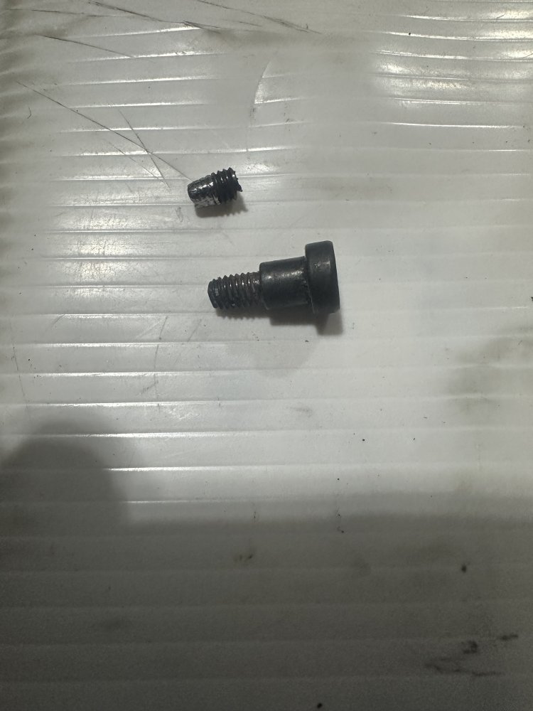

If it's not too late, would you mind posting up a couple of pics of the break?
Here is a picture indicating location of failed bolt. Also a picture of said bold and a one of the fragments I extracted from a the lower part on the backrest. New’r bolts from a wrecked donor ranger. Not sure of the size. This seems to be a week spot in the seat

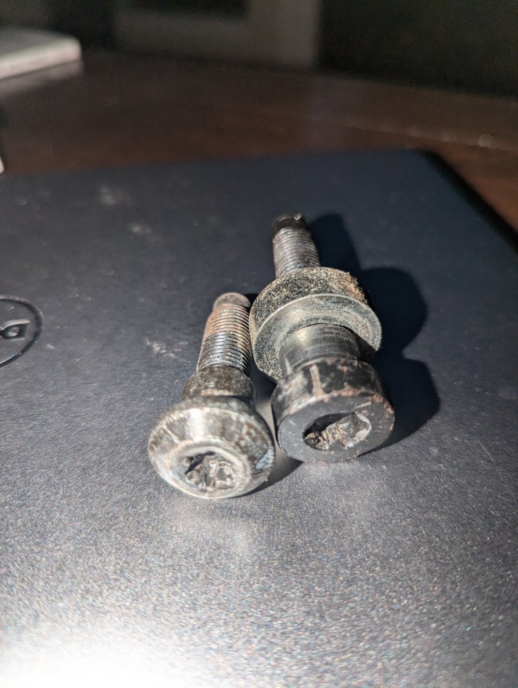

Do you have dimensions for the broken bolt?
I have some bolts from my 94 that look kind of similar that came out around the seat belt area.
One on the right looks pretty similar, but longer. One on the left looks about the right size but not the same shape.
