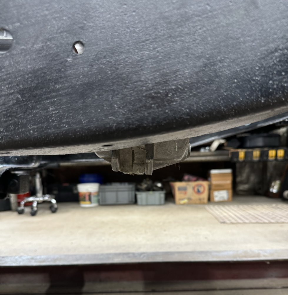

Checking back in to see if you made any headway with the 1356 fitment? Have you tried clocking it yet?
Been at a stand still with spring here and business picking up. Need to finish the floor pans n my cab to set it and see if clocking it will clear the floor - if so have to make new linkage. I’ll get another round of the bug here soon and make more headway

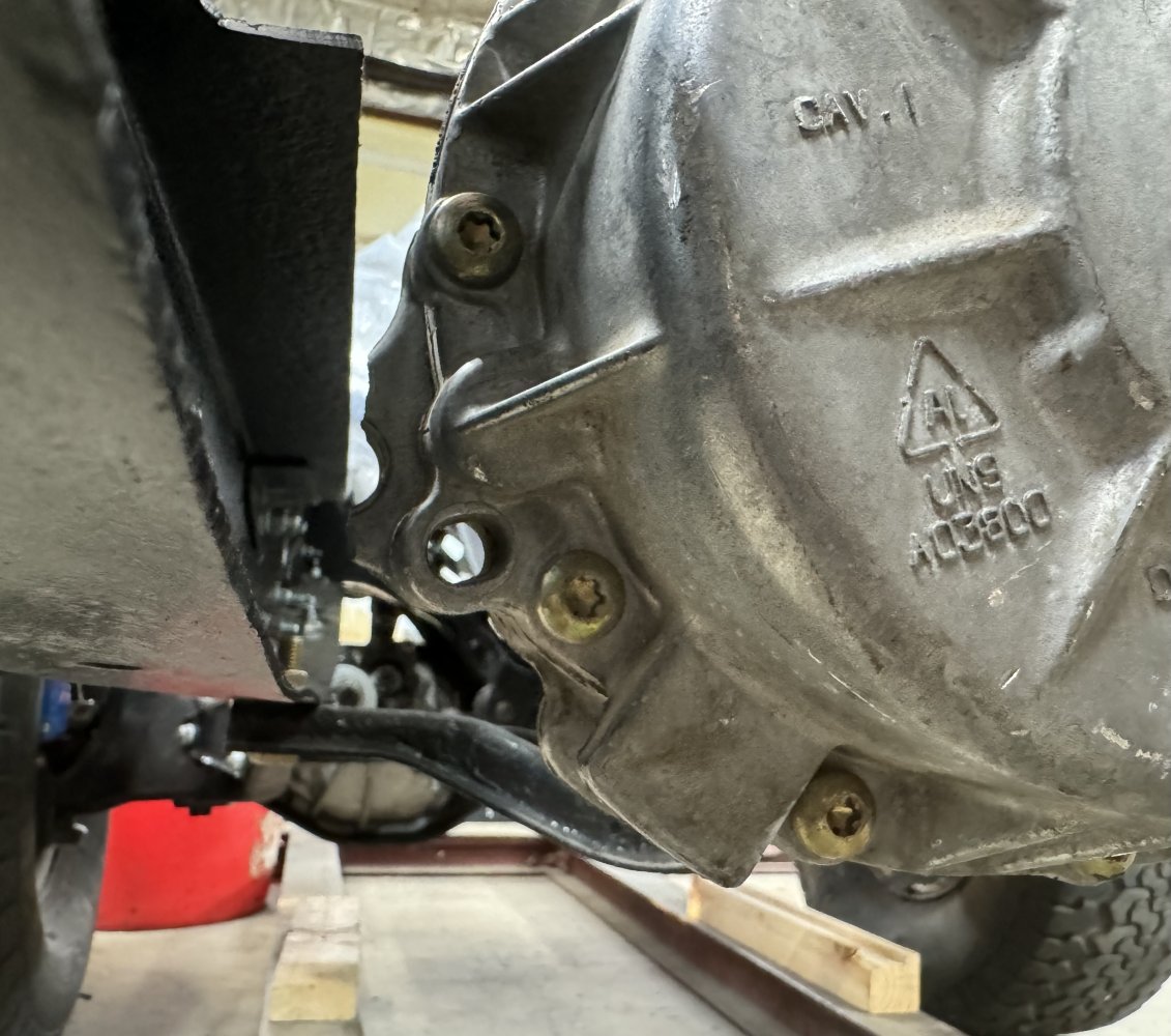

Do watch your front driveshaft clearance especially when you are clocking it. You can run into exhaust clearance issues very fast, especially with a D35 and factory springs (pinion is higher than a D28)
I used a factory '95 Ranger front driveshaft, the flex boot ended up right where the exhaust came down. A older style with just a seal would fit better (I had a rear driveshaft from a bullnose Bronco that would have been better but I gave it away before I knew I needed it)
Too much clocking will shift the oil bath so I am weary

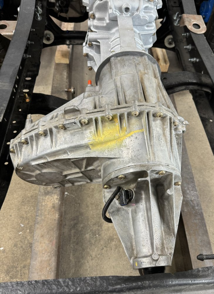

BW4406 does in fact fit in 83-88 frame
Much better fit than the 1356. Good to see this. Hard to see the vertical clearance with frame from this angle but looks like there is plenty! Looks to be a manual unit with speed sensor from a 99-03 donor? How are you planning to handle the speedometer?
I’ve got the mechanical Speedo tail housing. Just bolted it up to see if it was worth changing still
Small tab broke off in shipping - I would have cut it off anyhow. Front shaft line looks a lot better now as well
I also have a 4406 in my shed to use as an option. Came out of a '99 F150 with the speed sensor so will need to convert it as well. In addition to the tailshaft I believe you will need to swap the output shaft or machine it to accept a worm gear.
