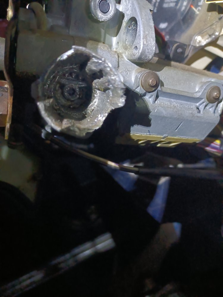

Im trying to figure out if i have to remove my entire steering column in order to fix the ignition switch and actuator pin. It has a drill whole all the way down the ignition keyway and the turning gear inside the key ignition is gone. I'll send a pic along with it, I'm not a very experienced mechanic so u don't want to have to pull the entire steering column out if anyone at all can help please respond back ty
You can replace the gear and cylinder as long as the part the cylinder slides into is OK
If "they" messed up the cylinders mounting hole then yes, another column from wrecking yard, not sure there will be "new" parts
Here's a pic

Bummer
I am pretty sure you can't use that again

Thanks i appreciate it I've bought from them before but i have 3 other rangers as well and one Is just for parts. I'll just have to do it myself and that one is something i have never attempted, but it don't look all that easy thank you so much for your help!

That looks pretty bad. Someone attack your Ranger?
