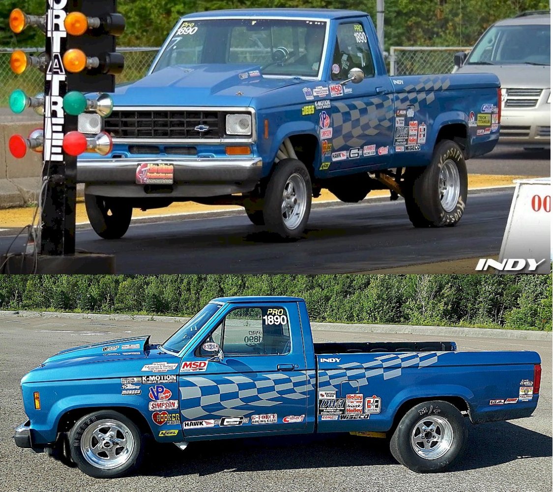

That would have even less suspension travel...
I honestly haven't paid attention to the older sway bar setup that was in the radius arms, depending on the setup it could limit the down travel...
Looking at your pictures though I have to imagine that the shocks might be the limiting factor, the 4x2 shocks aren't all that long, doing something as simple as moving the upper shock mounts up and putting longer shocks in to allow for more down travel might solve more than anything else...
