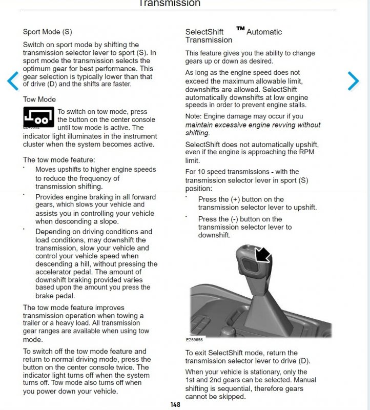

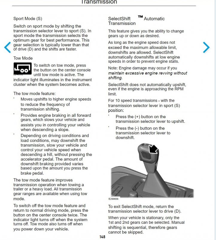

I drove a Ranger yesterday. You pull back on the shifter which takes it from "D" (drive) to "S" (sport) and then down shift with the button on the side of the shifter. It does downshift.... and it does slow the truck down, you can feel it and see it on the tachometer, just clicking it down once. Want more engine braking? Click it again. This transmission is designed to do that very thing, Ford calls it "SelectShift", see page 148 of the owners manual below.
As I understand it, when located in "D" (drive) the transmission may opt to skip gears, based on what is required for optimum efficiency. If you're taking off slowly it may go from first to 3rd, skipping 2nd gear. But if you mash the pedal to the floor it is likely it will not skip any gears. Using the "select shift" in "S" (sport mode) and then the SelectShift buttons you, not the technology, are sequentially shifting through each gear.
I've driven the mustang with the 10 speed. Exact same transmission. The mustang has paddle shift, I know the ranger just has the shifter up-down buttons but otherwise same thing.
What wild bill said is accurate. In sport mode you can manually shift but as I said before it's only partial control. It will stop you from downshifting too far. The button/paddle just stops working. The computer wont let you do anything beyond it's set parameters. So does it hurt the engine or transmission to downshift? 100% absolutely not, because the computer simply wont let you do anything that would hurt it.

Your excerpt from the Ranger manual just shows how every electronic manual push button gear selector works LOL, my truck just had plus and minus buttons on the gearshift on the column you pulled the lever down to S mode then toggled up or down to lockout the gears you didn't want it to shift into, so you'd select S-4 and it would shift from 1st to 4th gear...that's how every single one of these systems work regardless of which brand vehicle you have they work the same. They don't skip gears, they're just so closely ratio'd you can't tell its shifting. Some will not use 1st gear when in snow mode to cut down on the amount of wheel slip I know the Jeep Grand Cherokee and Cherokee do that, I'm sure many others do that have the terrain management/terrain select modes. Some even go as far as having a couple different ratio sets (electronically controlled) for certain gears under different conditions.
