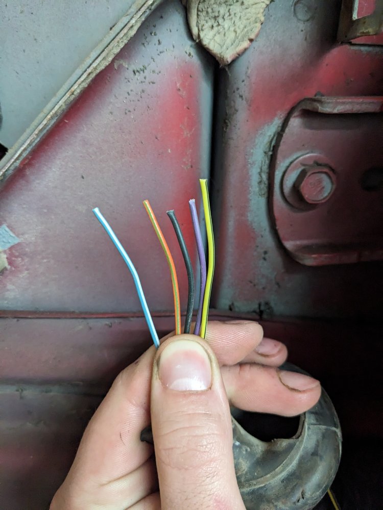

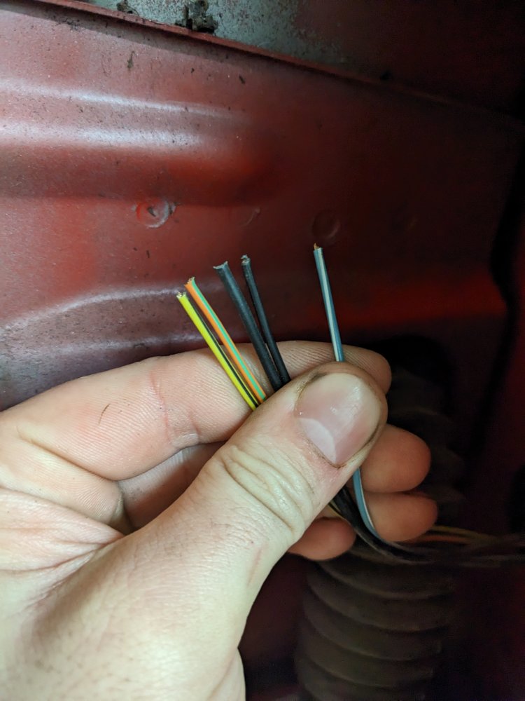

I haven't had much time to check schematics, but in the meantime I managed to take some pictures, the first picture with 2 black wires is coming from the door, and the other with the purple is coming from the cab. Weird thing is passenger side matched up no issues.

Figured I'd post a quick update, after testing, figured out the thinner black went to black, and the thicker black went to the purple.
