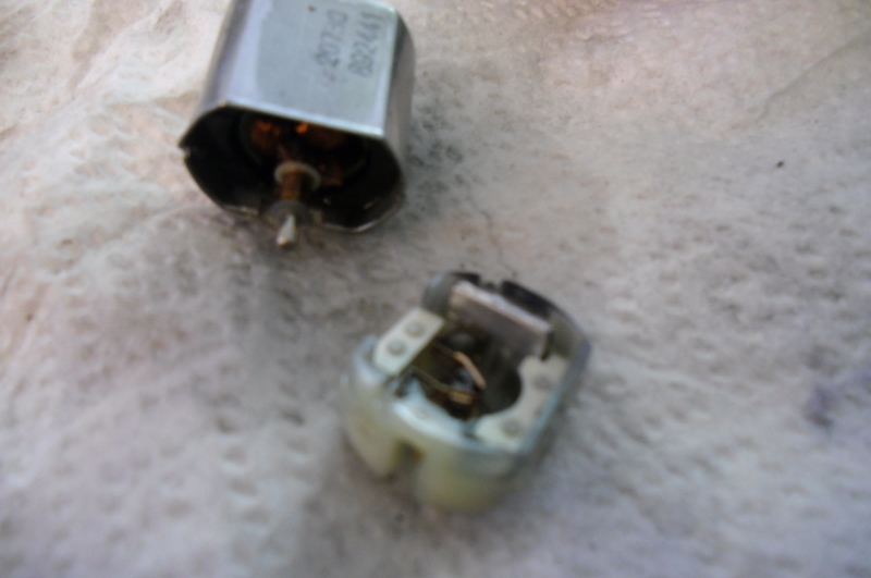

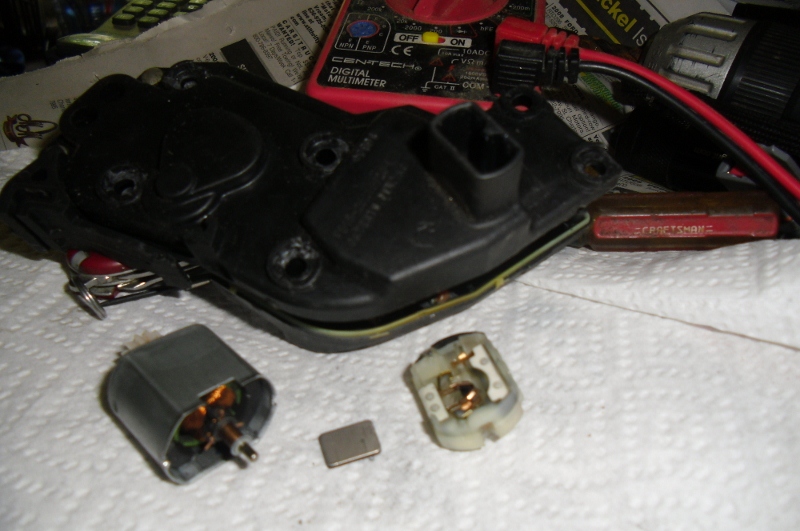

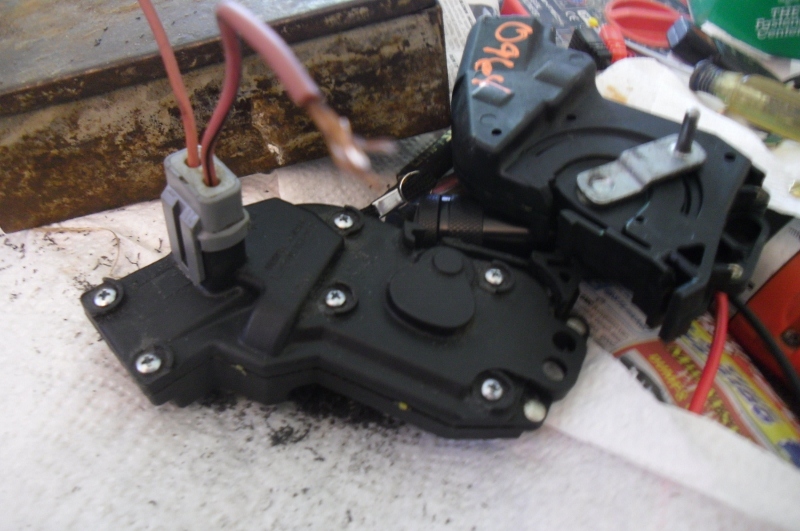

Finally figured it out,my good lock was not good to start. Lock motors have built in thermistors to protect overheating,when they go out they increase resistance to low/no voltage to motor,so locks just wiggle.
Disassembled,cleaned,greased and then wrapped thermistor(small rectangle) 0ne time with aluminum foil,screwed it back w/#4x1/2 metal screws for .25 and locks work great from switches/remotes. Beats $50 plus a lock.
