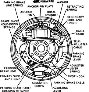

Done anyone have a view of their 9 inch brakes on a first gen? 1983-1990? I need to make sure Ive got all my hardware.

So, my wheel cylinder brew out and I took my wheel off to the wonderful drums being not fully seated, the cylinder exploded, and I cant tell if I somehow lost the hardware. I just need a photo of the parts and all together.
Thanks in advanced
They are all the same, even on the larger f150 trucks.
Thanks Franklin! Always a great help! I found it in my shop manual. It’s different depending on the left or right side.
