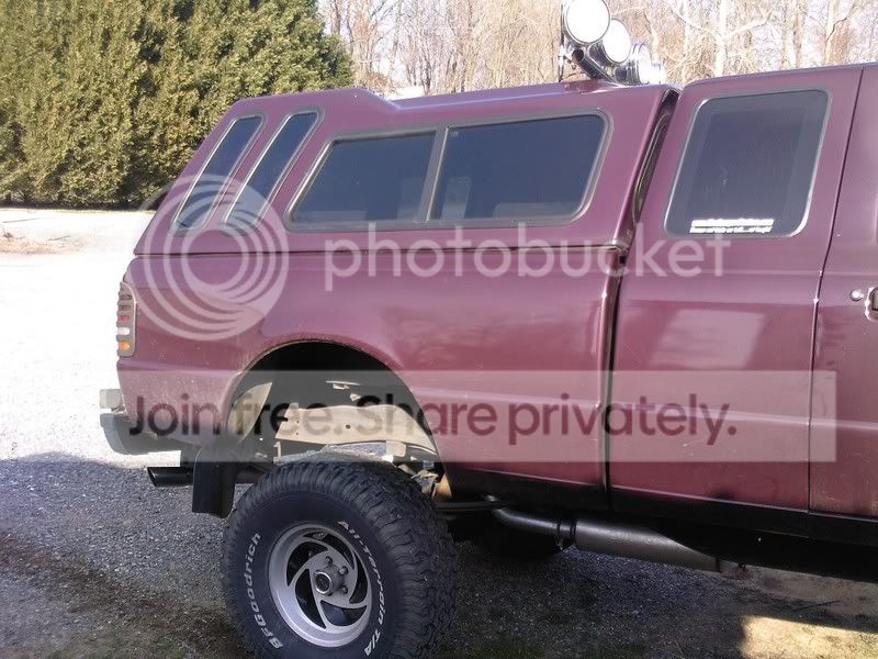

Does this quilify for off road?
Buckeyes903
Nov 27, 2007
201
Millersville, MD
1994
EDIT: Whoops-qualify would be the correct spelling
Took some poser shots at my g/f's farm the other day. If you look carefully you can see her haha
New Gibson exhaust is noticeable in this one
I would love to take it off road, but it has enough trouble on road, I have no idea how I would do off road...
Throw a locker in the rear and you will go anywhere a stock 4x4 will go. And with good driving skills ive seen guys walk through places in a Locked 2x4 that 4x4's werent going. Personally, im in the process of lockers front and rear so :thefinger:

get a rear locker and some good mud tires and u can do pretty decent offroad in a 2wd, just need to carry more momentum without the front wheels pulling, and also learn how to bump over stuff. you would definitely want to remove those lights under the front bumper if you start to do any serious offroading though
nice truck btw! i have the same exhaust, no where near as shiny anymore though
Yeah, I had another cheaper set under there and lost one when hitting something. I'm sure if i would do more off roading i would take them off. Don't worry I'm sure my exhaust will look old soon enough, its been on for 3 weeks.
