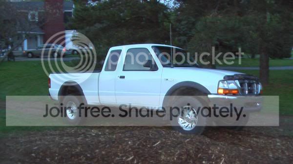

Here is a picture of my truck. it has 31 inch all terrain tires. im not sure if it has a lift or not. is there a way to look under it and check? or would you guys be able to tell by looking at it?

opps capps to lazy to retype but no just look at the back axle see any blocks ( between axle and spring

dosn't mean anything I think all 4wd ranger came with a 2 inch block from factory.

All '93+ Ranger 4wd's can fit 31's stock. My '97 came factory with a 265/75 (31x10.50) tire.
Correct. All 4wd Rangers had a 2" block from the factory to compensate for the front being higher on the 4wd models.
To the OP.
Your torsion bars may be cranked a bit to level out the truck.
There is some variation in how the torsion bars were set at the factory. My '99 Ranger sat a lot higher in the front than my '02 Ranger.
