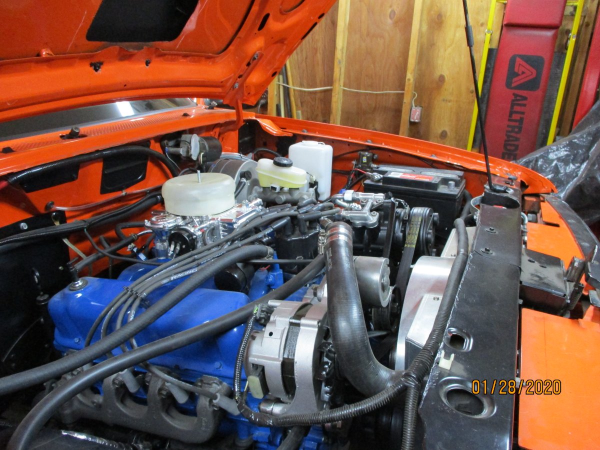

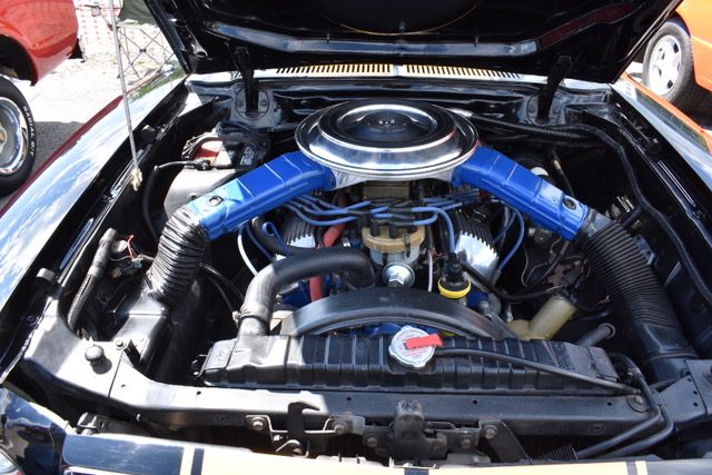

I run Holleys on my truck and Mustang. Years ago my son told me how great his Edelbog ran so we swapped carbs for a week, my Mustang felt doggy, the throttle response sucked, and it cost me 3 tenths in the quarter. Holleys are not hard to tune, you just need to pay attention to the way it runs after making changes. I bought the Holley on my Mustang in 1992 and haven't done much to it since I set it up, I've cleaned the air bleeds, replaced the secondary diaphragm when I changed the spring, and leaned out the jets a couple numbers after NH got rid of the MTBE in our gas. A stock 77 Mustang 302 turned a 17.7 at 78 mph in a magazine test and would get about 12 mpg. Mine runs 13.8@102 and gets 19-20 mpg with the Holley on a non stock engine.
