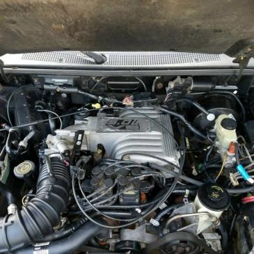

I just got done 20 minutes ago pulling the 5.0 out of a 98 mountaineer for my 90 ranger I am also going to use a mod5r2 trans from an f150 but im holding onto the engine harness computer and entire dash setup for a newer body style swap down the road. But im using a fox body mass air harness and computer to run this setup and im doing a custom instrument panel. So really a different fuel rail will be needed or another line to the tank it looks like. let me tell you its not fun at all tearing down an exploder your better off cutting the rad support and unbolting the motor mounts, drive shafts, and the crossmembers for the transmission and yanking and pulling until you can get to the bell housing bolts
