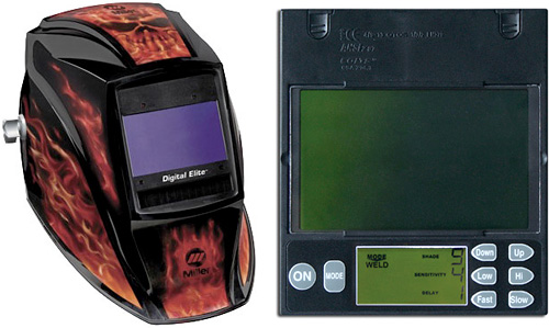

here is the one i have...i recommend it
I have two question for you.... how big is the actually viewing area? and how is it weight wise? i know the miller's are nice hood but never tried one myself, just dont wanna buy a helmet thats too heavy.
i have the same one as above but the older version
works Amazing. its not any heavier than a normal jackson flip helmet
