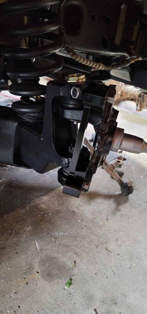

I plan to do a v8 but not to that point yet. I have the 3 inch drop beams up front. I did the 4 degree cam bushings something you want lowering it. I also did the front brake upgrade so I had the bracket machined to run the bigger 12 inch rotors off the 2004 sport trac explorer.

You will definitely have alignment issues without the 4 degree cam bushings forgot to add that
