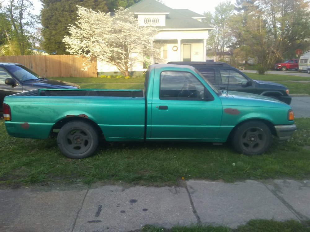

Well, here it is. It's done finally. Pain in the ass, start to finish. Ran across some rust in the frame that will need fixed soon as well.
26702
looks good, you can still do a shackle flip, add a block, or modify the leaf pack to get the rear down a bit more!
Although you'll be into the range were you'll be looking to add a bolt-in mini c-notch and raised tranny member.
Thanks, 2Krngr. Had the alignment done and everything is in spec but it still pulls right a bit. I do have to replace the sway bar link on the passenger side but not sure if that will make a difference.
