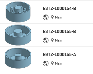

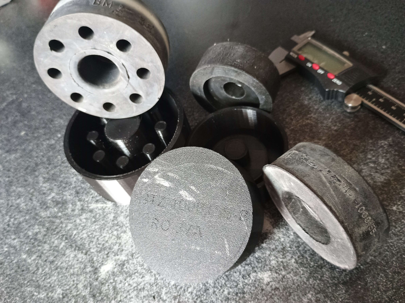

I have my hands on what might be some of the last NOS body mounts for the early Rangers/BroncoII. I'm using CAD to model up some 3D-printable molds in hopes of making it so anyone can cast their own. Some of the mounts have internal metal structures that have potentially acceptable substitutes available on McMaster. Smooth-On makes a line of "PMC" urethane that looks like it could fit the bill. "VytaFlex" looks like it might also work and be much easier to use. I'm spinning up my printer now to see what they look like. I have some more complex ones that I'm not sure how to model yet.
I'm curious what hosting you guys like for .stl files. Also if anyone would be brave enough to try out the prints on their own trucks and check my work.
Once I'm a bit more clear on the feasibility of this I will create a writeup/library thread for it with instructions.
I know it's not the same as OEM, but I haven't had any problems with Duff mount hardware.
I'm sure Duff stuff is good. I like their lift kit a lot. The problem I'm trying to solve is that no one makes replacement bushings that are as soft as original. I don't want a firmer ride. I'm recording what durometer each bushing is but casting your own lets you tweak it to your specific needs.
I've got some print quality issues to sort out, but everything pushes into the molds.
