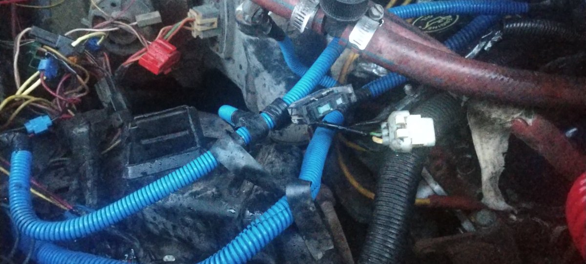

It turns out that the black connector pictured to the left was not plugged into the alternator. Unfortunately, I think that it is for the A/C cut out.
I have a second NIB 150a alternator which doesn't have those connectors, it has the white/gray only. I was hoping to use it but it looks like I'm going to learn by trying.
I am going to install the 150a, if that does help, I'm off to the battery Depot.
